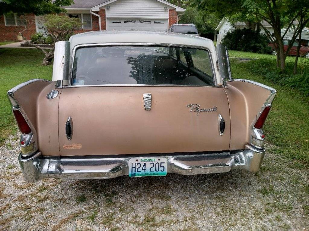

i bought a 60 Plymouth Suburban recently. Got it with no keys, so I'll have to send out ignition switch to get keys made. My question is the tailgate lock, the car has a power gate window operated by a switch to open/close with a key. I know the doors and ignition key is the same. Did the tailgate have its own separate key ? Or will one key work all 3 ?

Wagon tailgates were considered as a "door", so they had the same key as the doors... and ignition.
Tailgate cylinder usually has to be removed from the inside, a clip holds the assembly in. Once out a good key shop can duplicate the original key, which will then work on the rest of the locks.
