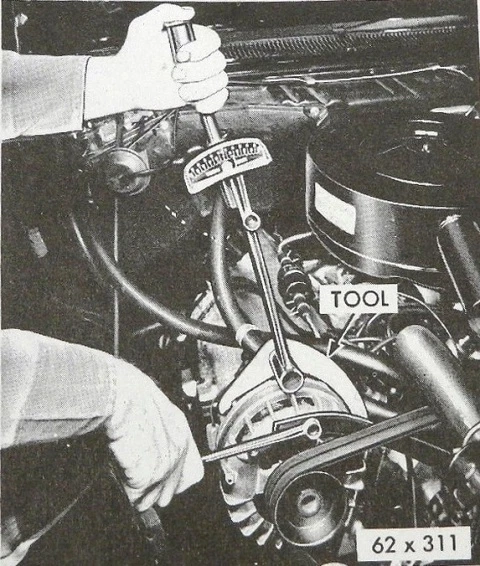

Since I'm on the subject, I bought one of these tools a couple years ago and I wonder how I got along without it all these years. This makes it a lot easier.
Buy one here: Chrysler Alternator Belt Tension Tool
I could use one of these tools as well, but this one says only applicable for '61-'68 alternators. Is that true? Will it fit your fuselage 300 (or maybe this is on that car...)?
I'm using it on my '70 with a square back alternator, so I'd say it's good.

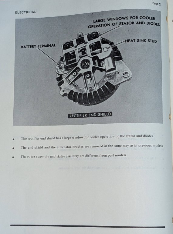

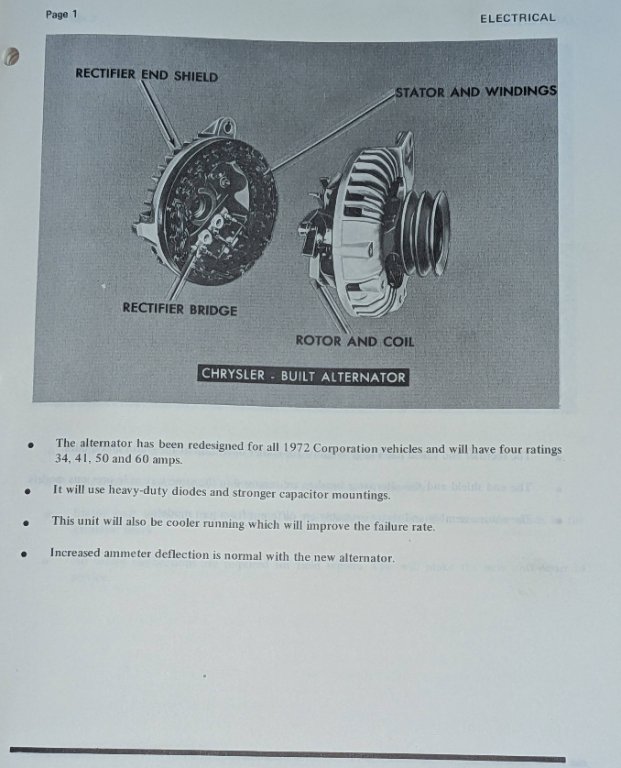

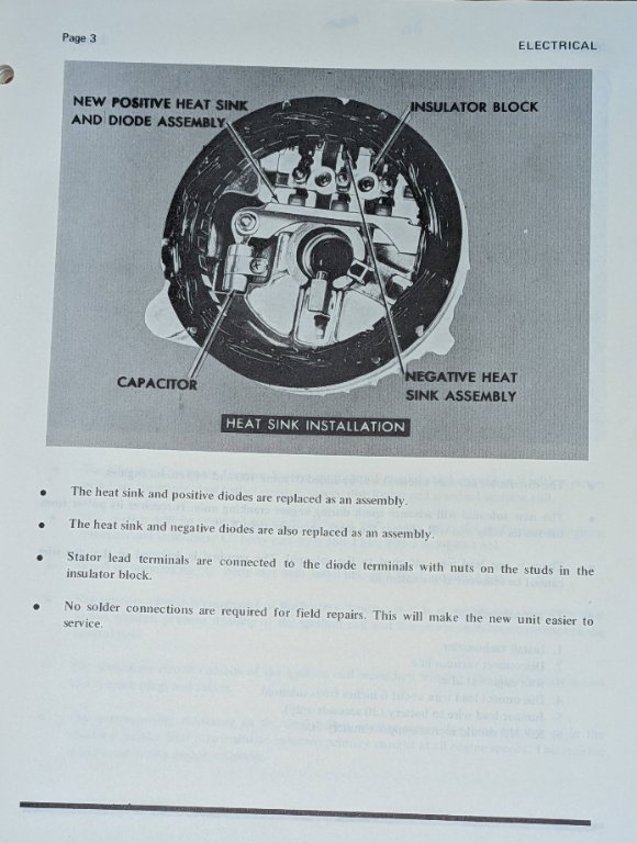

FYI...
For the 1972 models, the rear end shield of the Chrysler alternator was redesigned in the informally termed "square back" style. The end shield contained a different mounting for the rectifiers and capacitor and connected to the stator without soldering. This change simplified assembly and service operations,and improved alternator reliability. The electrical functioning of the alternator remained the same with the "Isolated Field" introduced in the 1970 models with the informally termed "round back" style case. This particular "square back" style was used through 1977 when the alternator end shields and stator were redesigned again. The 1978 redesign is still a "square back" style with the most visible difference being the "thin" edge of the stator between the two end shields. This particular "square back" style was used through 1987. The two versions can functionally interchange as a unit with possible light case interference in earlier bracket applications.
1972 changes announced in the 1972 Service Highlights:

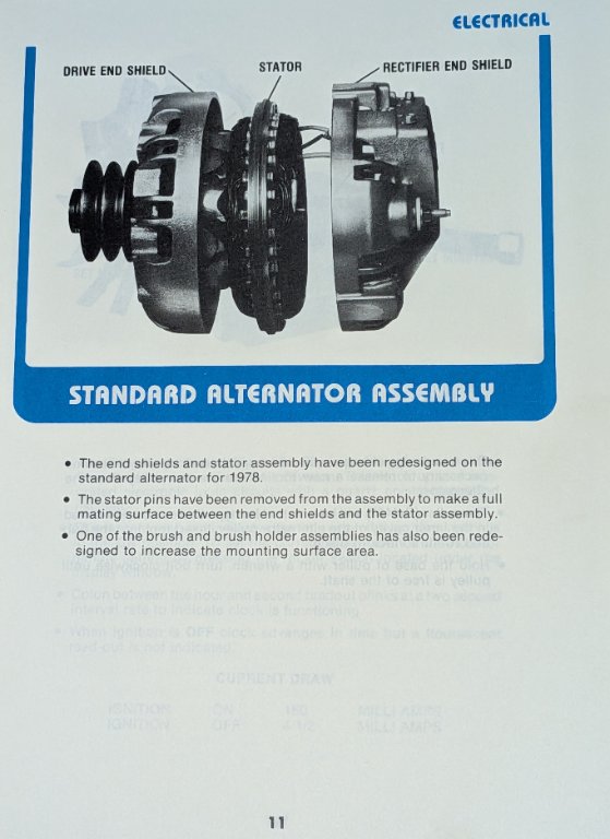

1978 changes announced in the 1978 Service Highlights:
That's the big advantage right there. I've changed those rectifiers in minutes. The soldering on the round backs isn't that bad, but the wires are often too short to trim (like from previous rebuilds) and then everything has to be pressed in and out.
How does that alternator tool hold the alternator? Does the end with the longer tip hook into the cooling holes/slots? Would be very nice to have but I've been getting by so far with a crowbar for both that and the power steering pump. Found an ebay listing for the tool which had a picture, presumably for A bodies though so might be different to how it's used on the C bodies:
Catches on the fins. AFAIK, it fits everything with that style alternator.
I've seen crowbars crack the cases on the alternators, so I always used to just pull on them while tightening the clamp bolt. It's a little hard for me to do that these days, so the tool comes in real handy.
