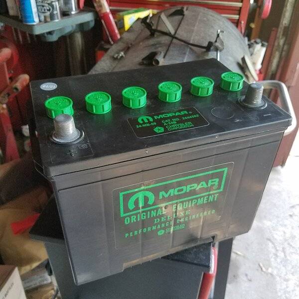

And if you want to have a Mopar look-a-like battery, you can get a black case with pry off caps and a sticker kit. I bought an Ever Start at Wal Mart and a cap and sticker kit through e bay. Here's some information on a FABO thread I started. Mopar battery dress up kits and cap color chart

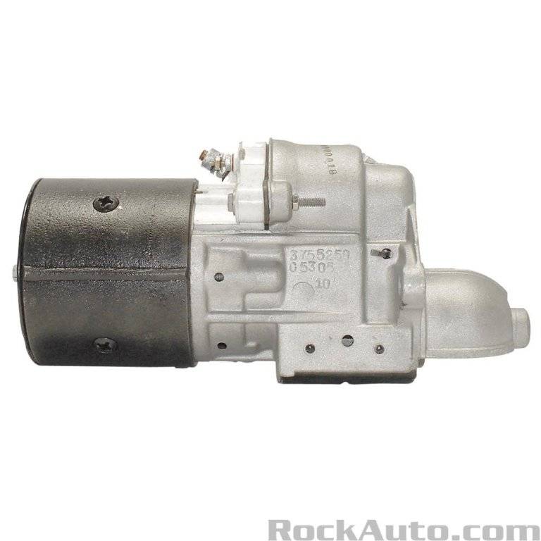

Over the course of owning 8 c-bodies, I find that having the high torque mitsubishi ministarter makes a huge difference in filling the float bowl and starting the car.
I have installed them on 440s and small block 360/318. I think would install on 413, but have not installed one on that BB.
Use this adapter kit for ease of install. Seller is a member here. @Badvert65 . Maybe he or @413 can comment on specifics to install on 413.
For Mopar: Premium mini starter conversion/relocation terminal Kit | eBay

Cell cap colors were an easy way for production line people to see which battery went where on the assy line, I suspect.
What are FL 61 cap colors?
I’m guessing,red?
Should be red for the group 27 and green for the group 24.
For anyone wondering, the eBay link for the caps and decals, along with some other cool stuff.

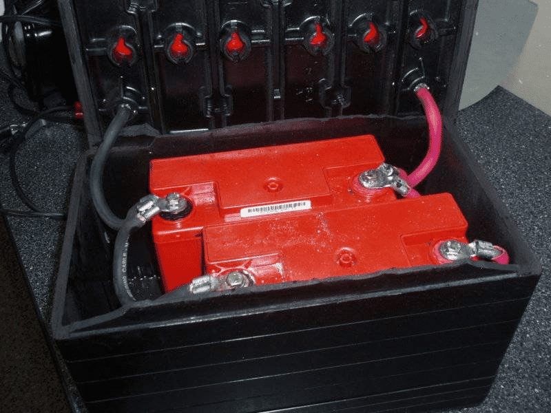

FWIW, the reproduction batteries are shells with sealed motorcycle type batteries inside. I have one in my Barracuda and you look in the filler hole and that's exactly what's in there.
Mine too. I thought I killed it a couple years ago when I left the dome lights on. I trickle charged it for a coupke weeks and brought it back to life. I put the link to the e bay site in my first post.
