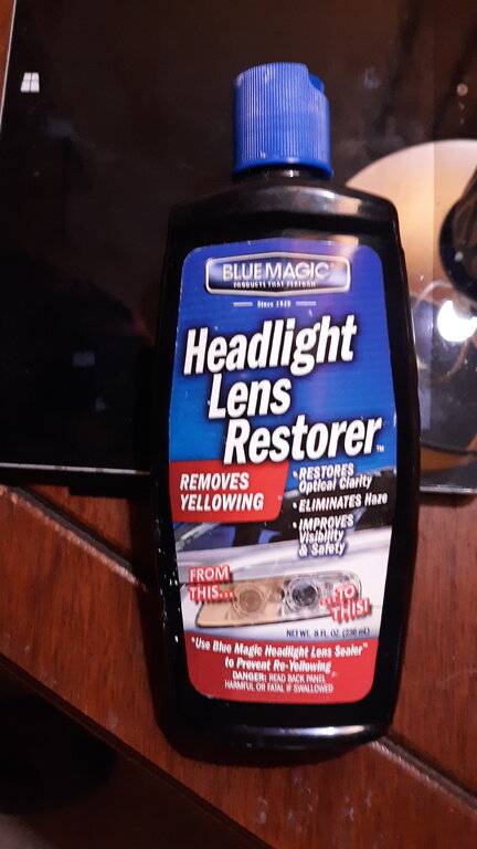

My approach is similar to 65sporty, I start w/ 1000 grit wet/dry sandpaper and wet sand in 200 grit steps ending at 5000. This combined w Blue Magic Headlight Restorer applied w/ a small polishing ball or cone on a 1/4 drill. The results will amaze you. The more care in prep and sanding, the better the results.
