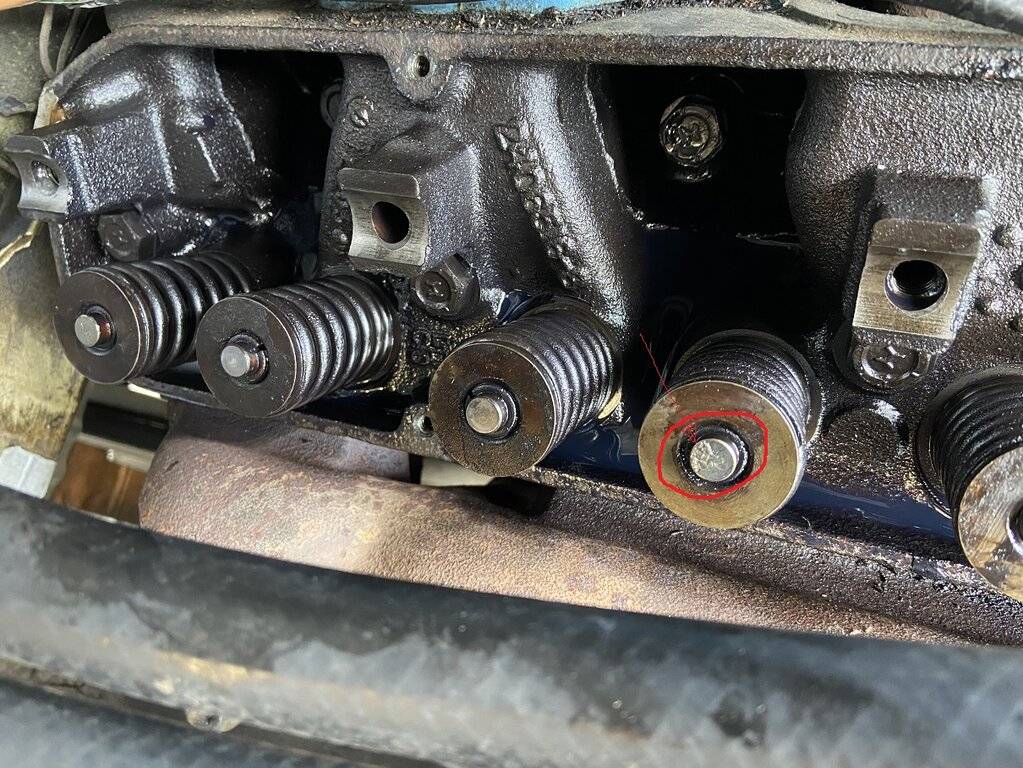

To be honest I'm not absolute sure on the root cause for my Exhaust Valve noise on cylinder no. 6.
While engine is in idle, I could reduce the noise by moving the rocker arm to the right angainst the side stop (not the spacer inbetween). My idea was to replace just the single one exhaust valve lifter to close out the lifter as the potential noise source.
I think noise could also be a valve guide issue due to this strange pitting on the top of the exhaust valve (it is just on this single valve).

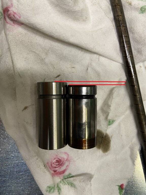

Original 66 lifter is 2mm shorter than the once Mopar shop did offer to me ( sealed power HT812 and HT976).

On the lifter, the critical dimension is not the end-to-end length of the lifter, but the face that contacts the cam lobe to the cup where the pushrod sits in. It is true that the earlier pushrods sit lower inside the lifter, so they are longer. They also have a smaller ball/cup on the lifter end than on the rocker end, unlike the newer style which have the same size ball on each end of the pushrod.

What's the bottom of that lifter look like? When they wear it will cup and then the cam lobe will be worn also.
