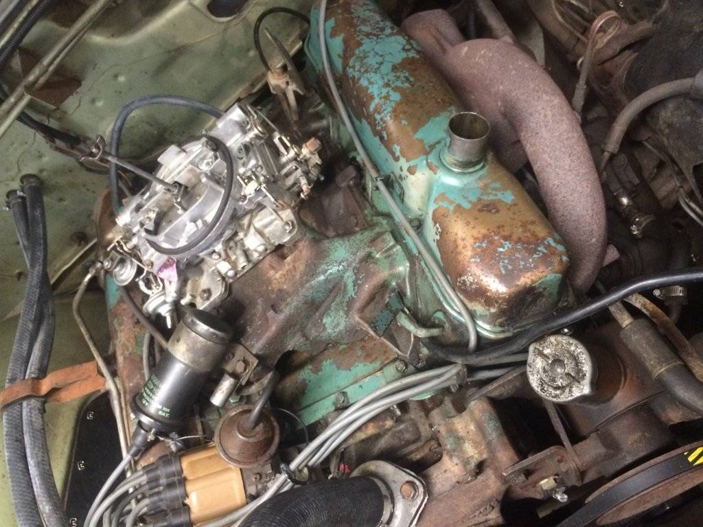

Latest thing, I don't think the original AVS had ever been off the car let alone rebuilt. Before and after pictures. Pump plunger must have been completely shot, adjusted the choke settings, now it starts cold right away without all the cranking and the dash pot so the shifting is smoother. Overall runs much better.
