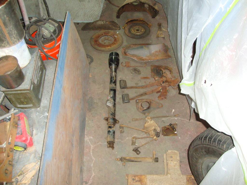

Could someone tell me what 4 speed setups will work in a 66 fury 383 car thanks?
this is what you need to put a 4spd in a c body 65-66 . plus a 66-69 a833 from a b or c body . your auto driveline will work asis .

Does anyone know where I can get the clutch fork required for this set up? Have one for a pivot ball type but bell housing has the non pivot ball style pivot bracket.

I guess I miss spoke saying this set up. To clarify I meant my setup which has everything pictured with exception to the clutch fork. Looking for one.
That and those short shift linkages. The ones that I have are way too long.
that the early type b body 64-69 , 70 the trans changed to have a different mount location and the e body shifter mount added to the rear of the tail stock . the trans mount should be the same as your auto , yoke n driveline also . i'll check that fork , but the bellhousing is the same as the b body one of the same year . 130 tooth flywhl 10 1/2 '' clutch , same as my 66 sat had . if you plan on the larger clutch , you most use the 143 tooth flywhl for the 11'' clutch . and those bellhousings have a larger reg hub hole .
Strangely enough I have the 130 tooth flywheel with an 11 inch clutch. The pressure plate covers the entire flywheel except for the ring gear. I have measured the clutch and the face of the pressure plate and both are 11". I have seen larger flywheel which I don't see how they could fit inside the bellhousing I have. Bellhousing bolts up to my 383. Does a 440 take a larger bellowing?
no , the 68up track package started that 143 t flywhl and 143 t bell housing is special too . glad your clutch is 11'' , thats a heavy car . well 70 or 71 started the 143 t use on the 383 . not sure if they used the same track package trans . so to say theat big block mopar has three different flywhl bell housings set ups , 130 , 143 , and of course the hemi was 172 . if you look at scatter sheild bells there is three different starter mounts , one for each different flywhl dia . i'm not supprized your has a 11'' clutck , i got a 12'' on a 143 t flywhl . between cars and trucks there is alot of stuff out there .
