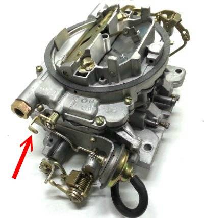

Here is a picture of the Carter AVS, red arrow indicates where the rod from the choke spring connects to:

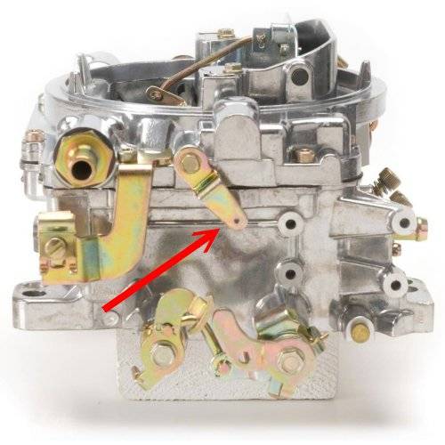

Here is a photo of the passenger side of a manual choke Edelbrock Performer carb, red arrow indicates where choke cable would connect to:
I am pretty sure one could loosen the screw holding that tab with hole on the choke shaft so that the tab could be repositioned.
You would have to put on the choke pull off
Thinking about it... the Edelbrock Performer carbs with electric choke don't have a choke-pull-off. So putting on the pull-off is probably advisable but not a requirement.
Also this still leaves open the question whether the original rod coming from the choke spring in the intake manifold would connect to an Edelbrock Performer carb (a) not at all (b) easily (c) with a little modification of the rod, or (d) with a little modification of the tab/lever at the passenger side end of upper choke shaft.
My vote goes for C or D, but lets see what other members have to say about it.
