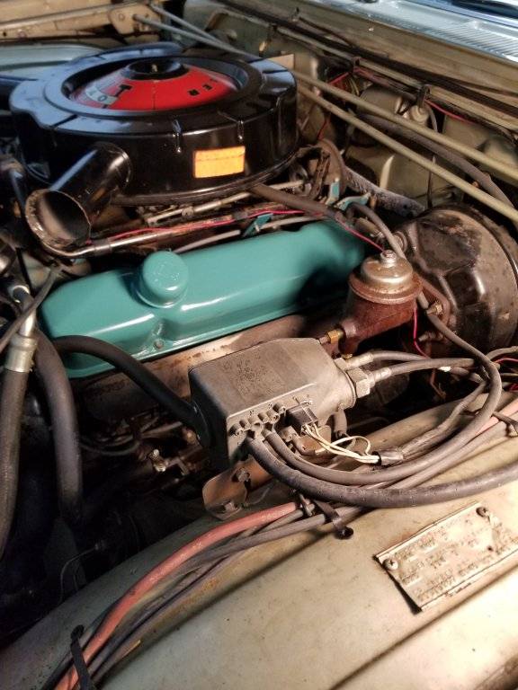

I have a ‘65 Imperial with the 413 in Chrysler turquoise. I have seen that POR-15 does have the same color that can be brushed on or can be sprayed with a spray gun.
On the other hand, I found the duplicolor rattle can.
What would you recommend for the best finish and what would last the longest? I’ve heard some people use regular automotive paint but I am not sure if that will hold up with the heat.

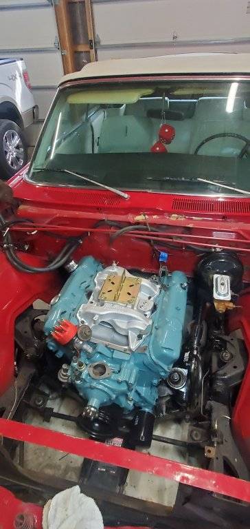

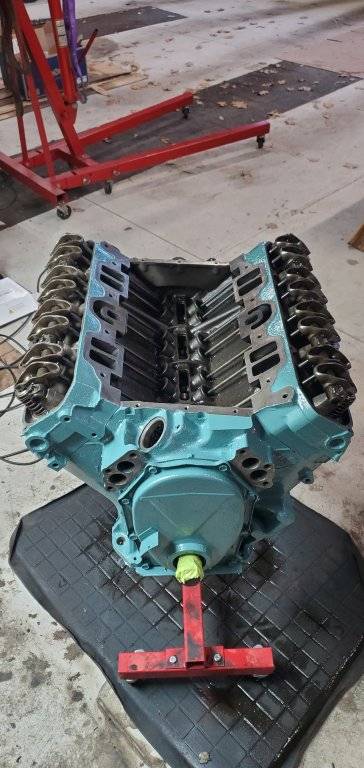

I used POR-15 with their Gray rust preventative as the base coat and it turned out very nice with what seems like a very durable finish. As with any job, prep was the hardest part. That said, I can't speak to the durability as I just did this a few months back and haven't run the car more than a few minutes since.

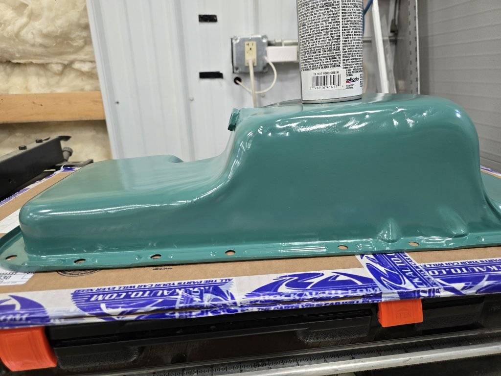

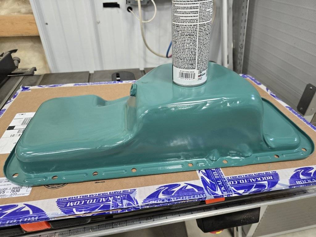

66 Town and Country - Just painted the valve covers and oil pan with Dupli-color DE1617 Ford green. It was an exact match to the original plug wires looms and other parts on the engine.
That looks really nice. And to me I feel this is pretty close to the paint I have left on my engine. Did you put a clear coat on top of it or planning to do it?
