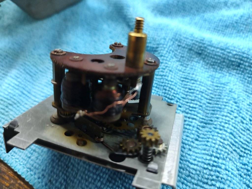

Mine has the power wire to the coils burnt and the coils look burnt too
That happens on GT / General Time / Westclox clocks when the car battery gets low on voltage. It's too low to "fire" the coils and they overheat. I have a few NOS mechanisms I swap in when I run into this.

Thanks. If I had the coils I couldn't switch them. Too much shake from agent orange haha.
