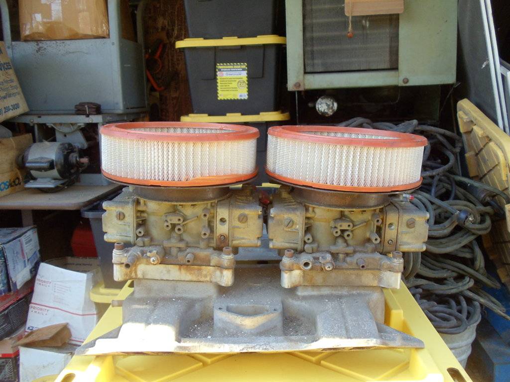

When she goes back together it will have what is reportedly what was dealer installed for the FBI back in 65 on this car according to the FBI agent who drove it and ended up owning it which will be an Offy dual quad intake with twin Holley carbs (450 cfm each)
my 65 880 rag 383 2bbl , to twin fours 660 holley's inline
, solid cam , headers with 452's would pull to 6k 120mph in second (2.91/76 r/e ?) , then shifter into drive and it would lift the nose and rocket way , better then 140mph . wasv just a 2 bbl 383 before it roared . swapped a 6 pck for the twin fours , used the 480/284 hydr cam , didn't run as hard on the top , but was more townable . it had 130k on it when i started .
Cool. Any cam suggestions for a 383 running twin 450 cfm carbs with a 4 speed and 3.23 gears? Is that the cam you ran with the dual quad? How was the idle?
