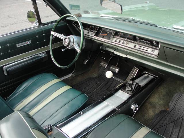

Not 100% on 67's, or the Chryslers, but in my 68 the console is common to B bodies so the parts are out there. There are reproductions I'm sure too. If yours was originally a console car hopefully the brackets
are still on the floor.

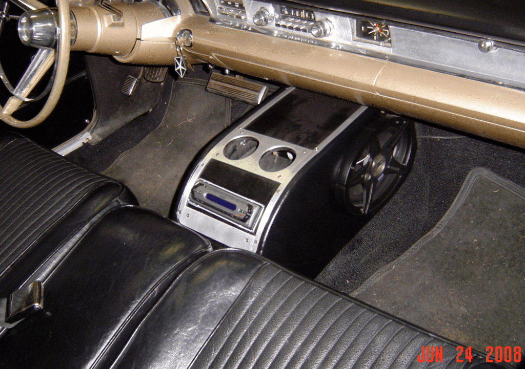

Here's what I did in one of mine years ago.
While it is homemade, the aluminum cuts out some of that 'puffy and wrapped in vinyl' look that makes these sorts of things stand out as homemade.
Ignore the fugly 6x9 speaker grilles, I should've sourced/made something more elegant/subtle.
