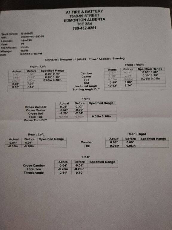

Sorry to hear about that. Sounds like you didn't get ahead, and they didn't make any money. A lose/lose situation. This is why alot of places won't even look at old car's. Here's a printout of my last alignment. Done by a professional. This car had the torsion bars dialed all the way up for over twenty years, and ten leaves per side on the rear, don't ask! After removing the extra leaves and replacing all the shocks, I brought it in, he told me I needed ball joints, so I put those in and brought it back. It's still not perfect, but given how bad it was, I'm happy with the job. And he charged me extra, because there was alot of extra adjusting.
That’s what I have received in the past.
Why the difference in caster from left to right? (0.68 vs 1.20 degrees)?
