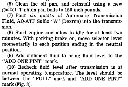

So gents, after repairing my leaking speed-o cable, replacing the gasket on the parking cable housing, and dropping the transmission pan and changing the filter, etc... I at last was ready to add back the tranny fluid and start the next phase. My manual says that my tranny fluid capacity for my 65' Imperial is 19, 1/2 pints, which is nearly 10 quarts. I started off just putting in 8 quarts or 16 pints, and from there I would fine tune it w/ the normal fluid check procedure. Well apparently 8 quarts was too much ...as I got the motor up to temp and ran the test ( while in neutral ) ...the dipstick indicated about a quart over the FULL mark. Surprised to say the least as i was still a bit away from the capacity of 19, 1/2 pints. Obviously I made an error somewhere, as it seemed 15 pints would've been right ...a far cry from the capacity amount. There must have been some fluid still in the car that doesn't drain when you drop the pan. Dang.
Is there any easy way to drain the excess fluid other than loosening the pan bolts and going through all that? Can it be sucked up through the dipstick inlet? Any tool for that?
