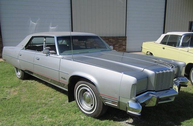

Last time the '78 NYBS was out of my shop and driven was about two weeks ago, when my wife (it IS her car!) took it out for a spin. It had been parked for about five months, mostly just because. So, of course it was pretty dusty and had six month-old fuel in it. Ran OK, but that was it. So, yesterday I took it out for my first drive in it since last October, to wash it and put a bit of fresh gas in the car. I think new spark plugs are in order for the 440.
My wife had complained about oil smell under the hood once the car was warmed up. Turned out there was a small leak at both valve covers. I put two new gaskets on it 18 months ago, but never checked the bolts afterwards - easy fix. I still have a leaky exhaust manifold, but have a pair off a '78 400 manifolds coming to me from the same guy in Iowa that I found the lower door panels for the NYB.
If I hang onto the car (likely), I think I'll replace the original vinyl top. It has started to peel at the very back left corner, and has one tiny bad spot on the very center, about a quarter-inch long.

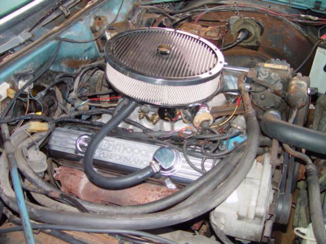

Chrysler released a grey rubber valve cover gasket for the small block engines that had both a metal core and torque retention inserts on both sides of all of the bolt holes. I put a set on a Maxi and they NEVER leaked. Did Chrysler ever doing anything similar for the 400/440 cars?
I installed new valve cover gaskets four years ago, but the car has only been driven a thousand miles in that time. I've got a pair of aluminum M/T and a pair of Mopar Performance aluminum valve covers I may go to, eventually. It's been with the steel valve covers that I've had gasket leakage problems with, on nearly every big block Mopar I've ever owned, regardless of year.
I use FelPro VS50145R valve cover gaskets from a 1970 Charger R/T with a HP 440. They are rubber coated fiber gaskets that are bullet proof. They are the High Performance / Heavy Duty gaskets. I also have a set of Mopar Performance aluminum valve covers on my NYB.
