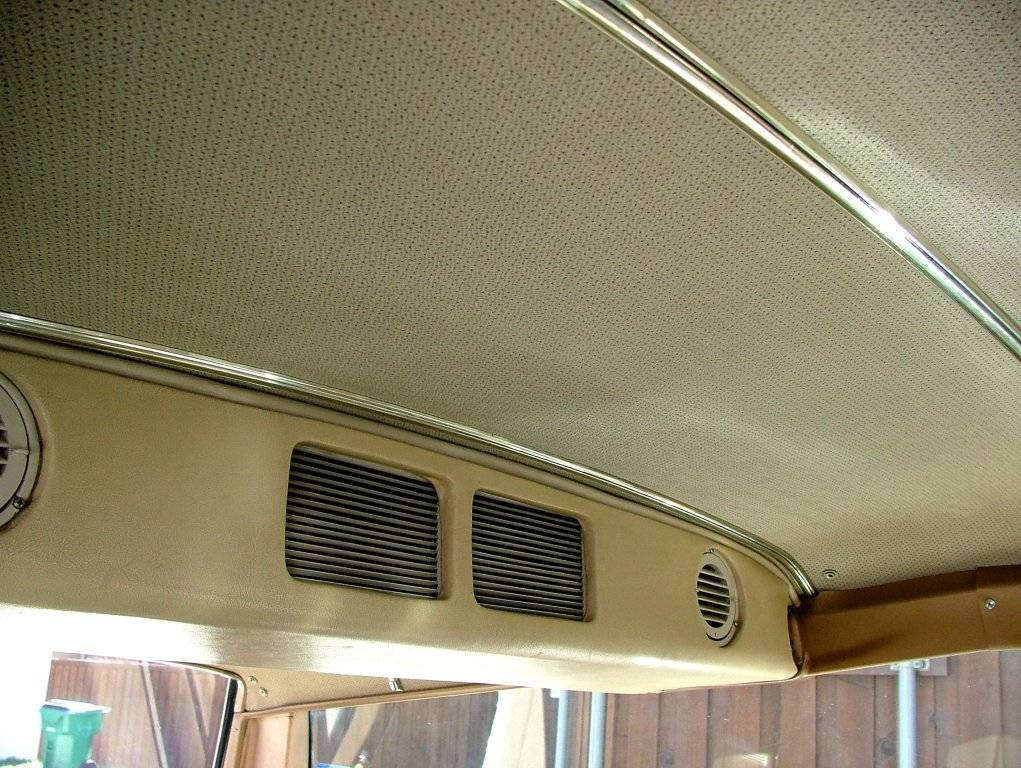

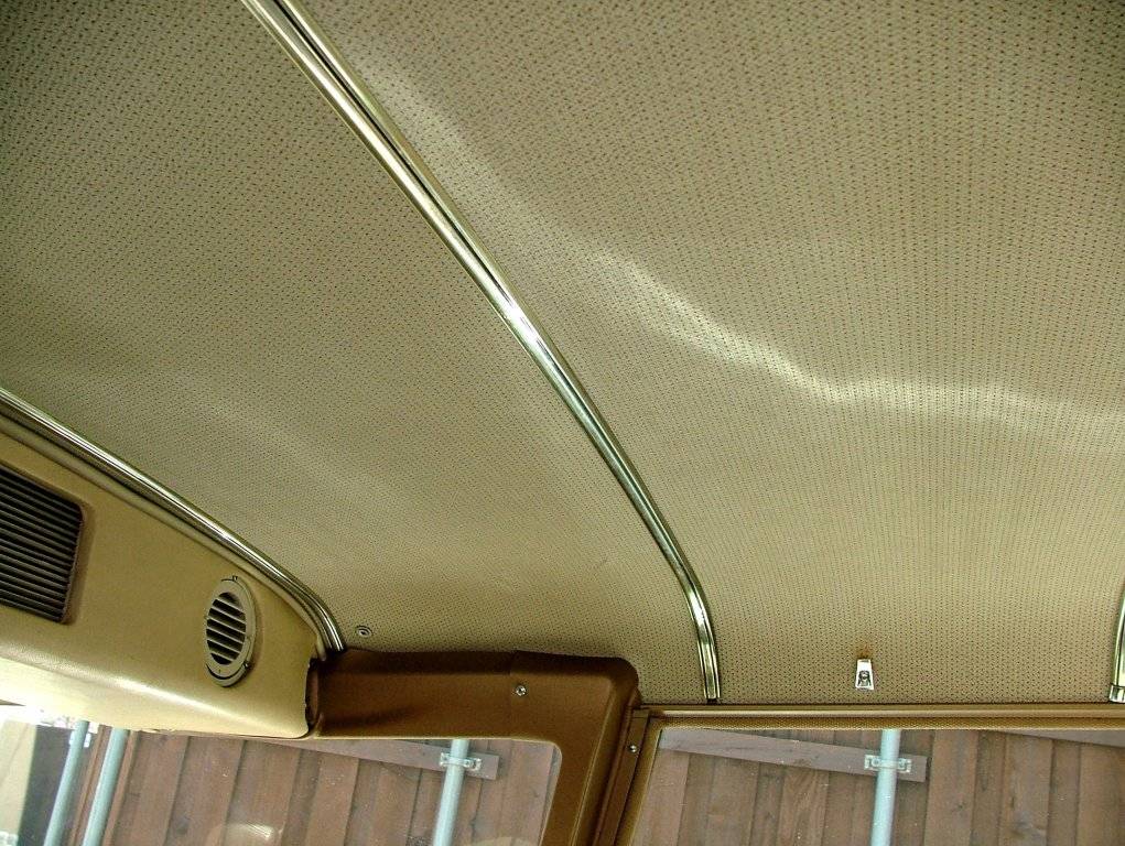

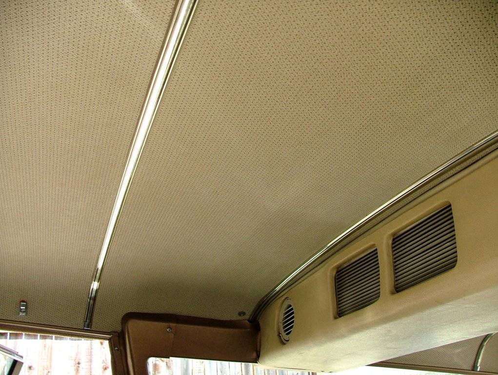

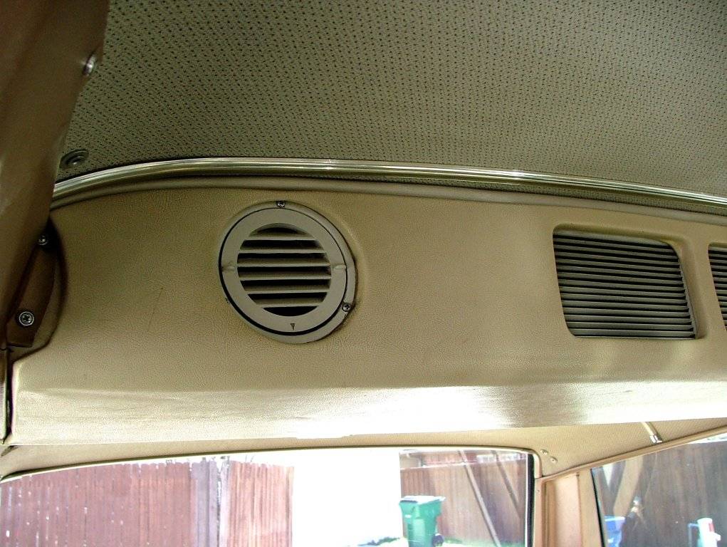

Did you keep all the parts from the rear AC system? There are a lot of specific parts that would be hard to fabricate - plastic pillar covers that hide the lines, special clips, pipes, drain hoses, AC lines with Amorcoil protection that run under the car, T unions for the suction and high pressure lines, and of course the overhead unit. The overhead unit is held in with special hinge brackets at each end.
Ask all your questions here - @TxDon and I can help
I love the dual AC in my 66 - it's like a meat locker in my car!!

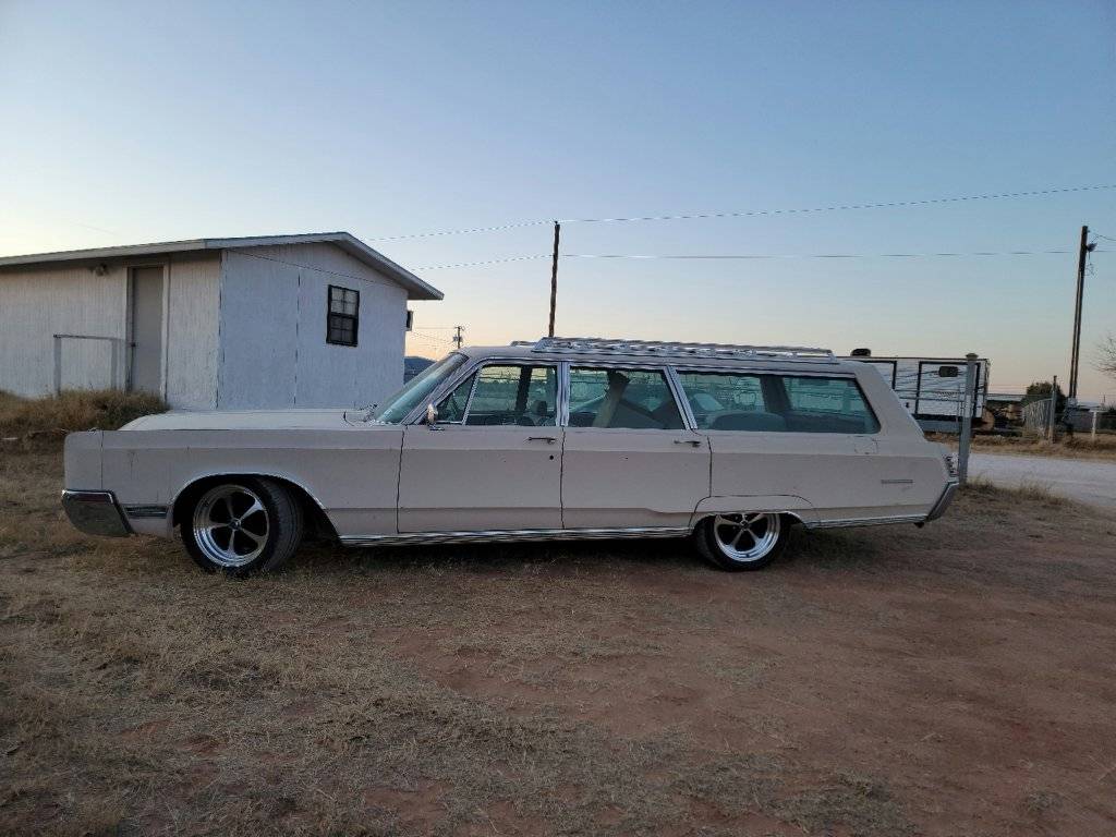

No, no parts were saved. It was in the 90's. Way before I was smart enough to think wagons were cool. My current wagon is a 67 t&c .
Also no photo shop experience. I had posted one picture when I first picked up my wagon, but nothing since.

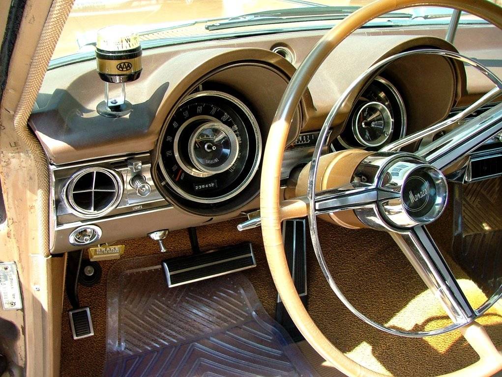

Can either of you tell me about the dash switch to control the rear fan? Is it single or multiple speed? (hi/lo) and where is it mounted? thanks
On the downward sloping part of the dash above the brake pedal in this pic. (On my Monaco)
