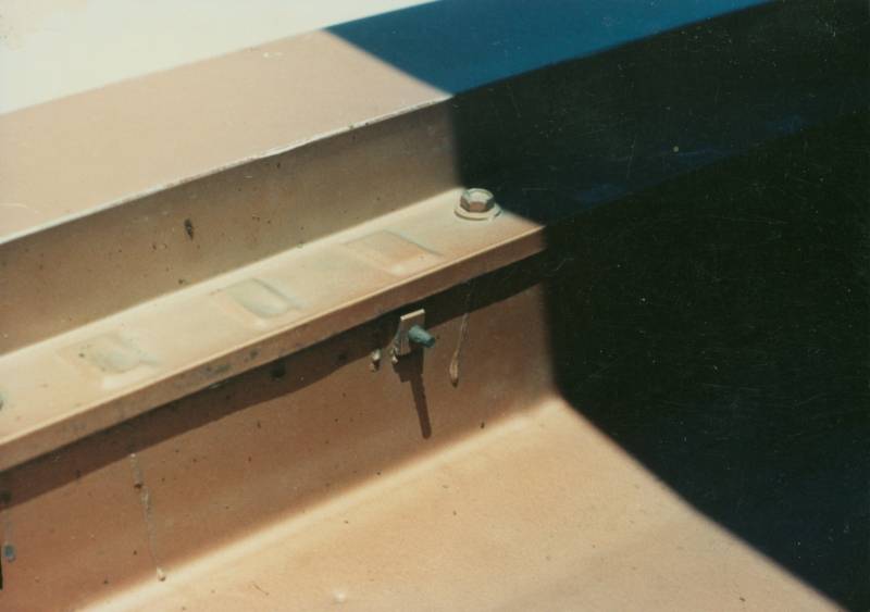

Thanks Alan - What I've found after the blasting cabinet... The battery tray was bolted to the inner fender and radiator support prior to them being painted (all painted body color together with areas of bare/primer only between the panels). The small bracket to the frame was black - probably the usual "dipped" semi-gloss. Bolts and spring nut for that bracket were natural from what I could tell. Still curious about the bolts for the fender struts. The struts were black which tells me they were done after the main color was sprayed - but were the bolts body color with the paint "disturbed", natural, black oxide?

I envision that this is how it was sub assembled and painted? To paint with the fenders it would have been mounted to the frame, which means masking which probably didn't happen? I this is the case the battery tray bolts to the fender and strut would have not been painted. But natural or black oxide? It seems that most of my screws that go into the frame were a dull Natural grey.
Mine is the 66, so full frame. I think the later ones are unibody with the front subframe. Reason that may make a difference is the "body unit" vs the "body in white" was produced differently. It looks like the Imp I have was assembled as a complete body unit in primer or dipped in it, then painted body color. So reinforcements that were added when the body and frame came together were spared body color and in most stuff I've seen is a medium gloss black, with runs because the parts were dipped - not sprayed. I'm not a restoration specialist so this is conjecture in some bits on my part. The bracket and fender struts were black. There was black under the body color, and under the bolt heads (where the finish is protected). My car was repaired once, and then someone also tired to refinish the engine bay. So it's a detective deal...lol.
If the battery tray brace attaches to something that is body color then the brace would probably be body color. In the case of the 69 Polara it attaches to the stub frame. As for the fender braces the bolts wold have been natural (phosphate) if they were put in after, I doubt the factory would pre paint bolts.
