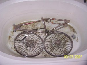

ive used oxalic acid on a lot of BMX bike frames.. but you have to wash and then oil the part as soon as it comes out of the bath, or it will start to rust again.

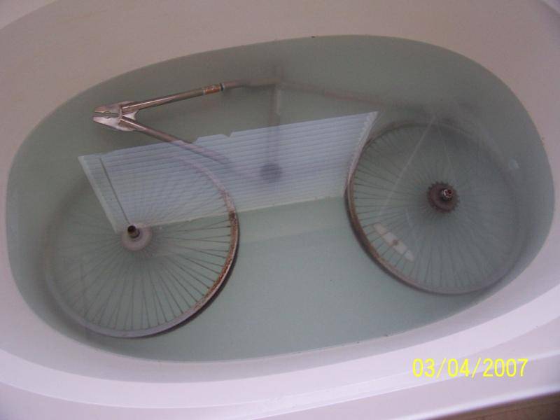

I have thrown a whole bike into a oxalic acid bath (in the master bathroom bath tub of course, where else?) tires, bearings, seat, frame, the whole complete assembeled bike. no harm, not even to the decals on the frame. let it soak a bit, and the rust is history.

ya a kiddie pool would work for a tub. you can use premixed behr wood bleach, I think is behr #63... but if you can find the OA powder/crystals, mix it yourself. I don't remember the mix ratio commando,,, but it was whatever the side of the container said... that maybe was the last bike I restored ^^ in 2007... so I haven't done it for a while now...I used to collect and restore old BMX bikes, still have a couple laying around. I kept that roger Decoster ^^ for sure.
