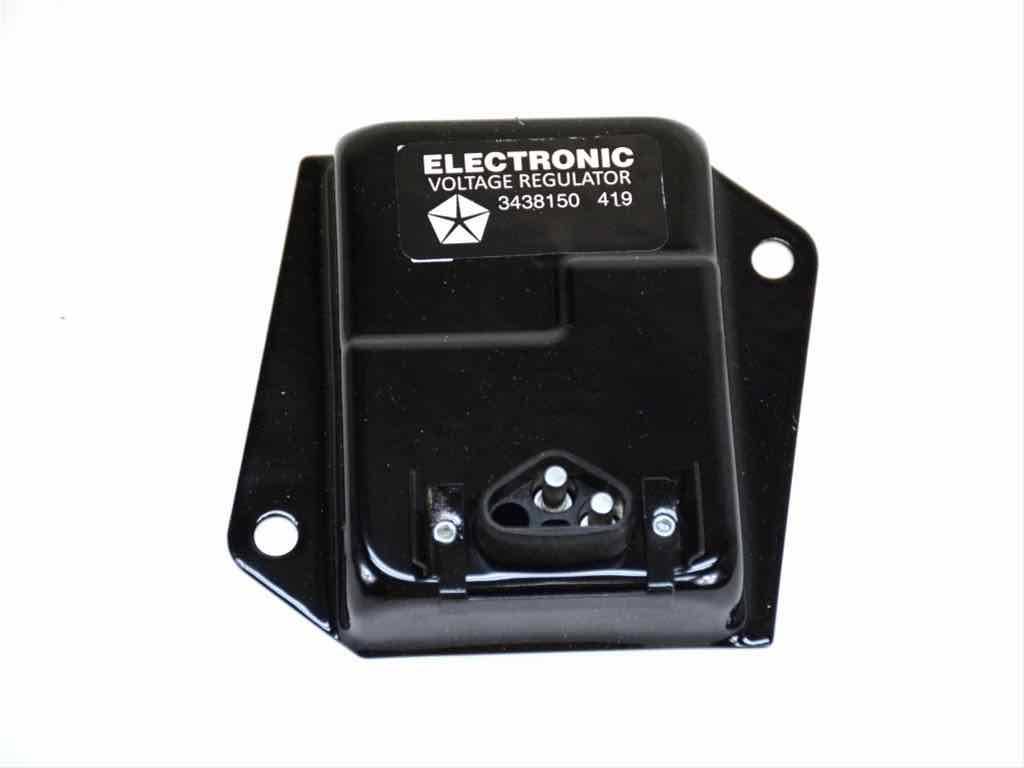

electronic conversion if your oe looks like this one I have
CHRYSLER DODGE PLYMOUTH Voltage Regulator 12v Alternator Electronic | eBay
or go with a mopar style one in the pic if you have the style like this
