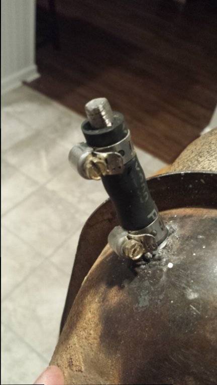

What I decided to do is: I bought a random auto zone pcv valve, I'm gonna cut the end off that a hose would clamp on to, drill a hole in the tank the size of the cut end of the pcv valve, weld that on flush with the outside of the tank, and just put a small length of hose with a plug in it to cap it off. This will allow it to drain the sealant easily! And anything in the future. I didn't want something that threaded in and out cause I didn't know if threading in a plug after it was sealed would remove the sealer in the thread zone and cause it to start peeling internally. I'll post pics when I'm done!
So I went to autozone and bought a random 3 dollar pcv valve, cut the end off that looked like what a fuel hose would go on, welded it to the tank. It worked great for draining. Then I got a stainless bolt I don't remember what size, cut the hex head off, grinded the threads down to smooth and used that to make a plug in a rubber line. I'll be reinstalling the tank tomorrow Lord willing, and With the Lord's blessing it won't leak either!
