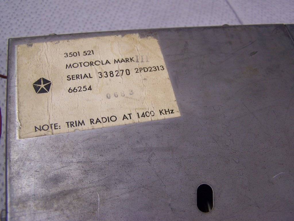

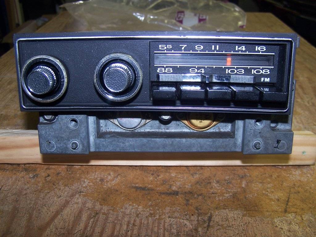

I have an AM/FM radio from a 73 Plymouth wagon. PM me if interested. $80.00 plus shipping. I don't believe these were stereo so only used one speaker in the dash and one in the rear. Don't quote me on it though.
Here are a couple pics.
Tested and plays on both bands
AM/FM Stereo radios were quite rare in Plymouths and Dodges before 1974, so it's going to be hard to find one. Going with a mono radio may be the best bet. The mono radios were generally better at holding a station.
