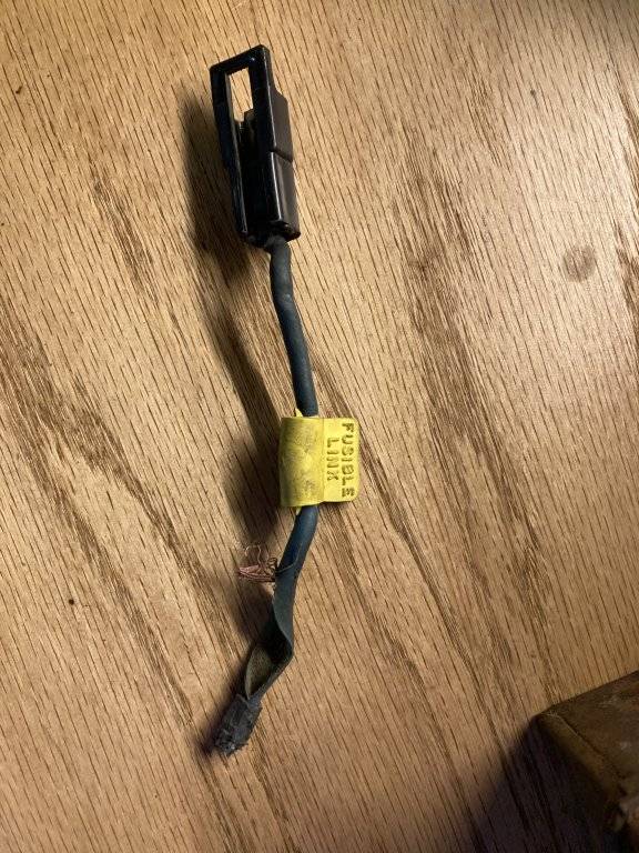

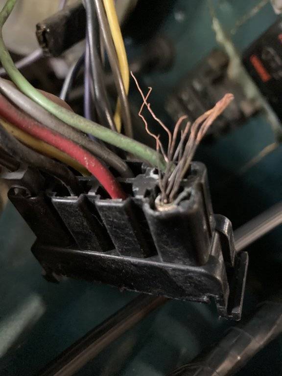

So my link went bad- I was able to get the one end disconnected but the end going into the connection block that goes to the firewall broke.
Looking for advice on how to get the rest out (1) and any thoughts on where I might get a replacement?
I’ve looked on eBay and there are a few that look close but I don’t have the big ring/washer type end on mine.
Thanks for any help.

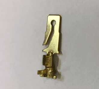

Flip it over and you'll see this connector. Squeeze the blade on the sides with a needle nose pliers to unlock and push towards the wire side. It should come right out.
