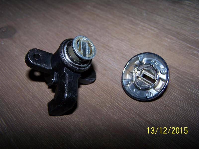

Finaly got the cylinder out of the lock...
Next problem: can this be repaired ? Chrome knob broke of the cylinder..

You're gonna have to find another one.

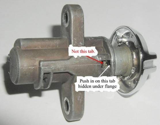

Did you just pry that apart? Here's how you take it apart.

No, the knob was already broken of so the lock came out easy... I watched this video several times and finaly got the cylinder out but only after I found this picture:
Took me a while to find that out ( was pressing the wrong tab pfff...)
