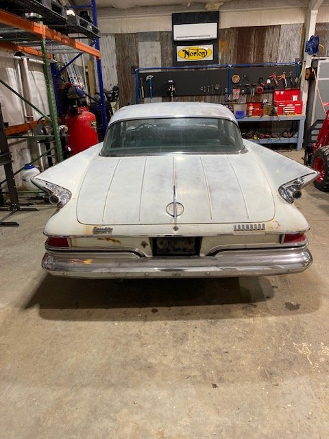

Me again. I have the 1961 Chrysler Newport 4 door with the 361. Just looking this thing over, noticing it sits kind of low. When pondering if a new set of leaf springs might do it some good along with 4 new shocks, I read what I could on leaf springs on the forum. Pretty sure I have just regular plain jane leaf springs for this cruiser. I counted the leafs and thought there were 5 but I may have missed one translating to the 6 that come with the stock leaf springs. So my question is, would there ever be a reason why a 61 Chrysler Newport would come with HD leaf springs? Not sure what I'm going to do regarding shocks, vs leaf springs, vs both. Just wondering if there would be any benefit or why someone would need HD leaf springs on a car like this.
