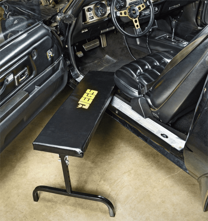

I'm thinking of building something like this, just a bit taller.
If the seats were out, maybe it would be easier. You could put some sort of little bench with some padding to make it less stressful on her neck. Something like you are showing in the picture.
