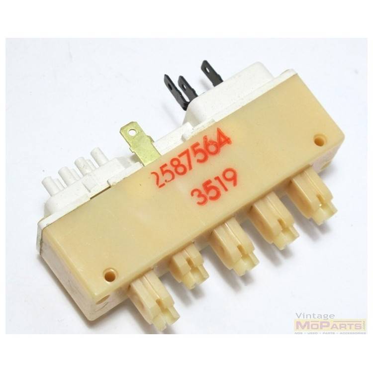

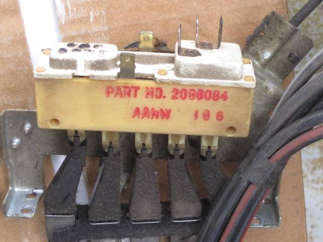

This is the dash vacuum switch.... All pics grabbed from the 'web.
This one has broken nipples, but it shows how the push buttons attach.

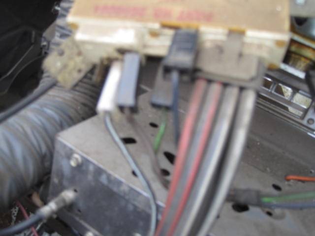

Same switch, showing the vacuum lines and electrical hook up.

The 7-digit stamped number usually is the correct Chrysler part number for the item pictured. What's on your control valve can be different, so verify that prior to purchase. Use THAT to determine which one to buy, not relying just on what the seller says it fits in a chart.
