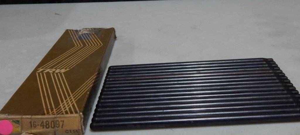

So after reading this original post I am trying to find out whether there are any high performance push rods as per attached photos, they have a ball on the rocker side and on the lifter side it looks like a bottle neck
Those are 67 and down pushrods,, most people upgrade to 68+. But if you need em I would try Smith brothers
