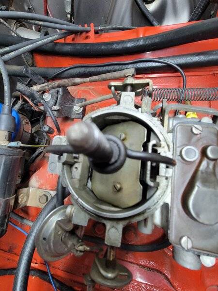

Tighten the kickdown linkage to raise the shift rpm. The kickdown lever pin on the throttle should be at the back of the kickdown lever slot. (depending on what your linkage looks like) The Poly in my 64 doesn't have that kind of linkage so the slot I spoke of may not be on yours. Too far and you will have to back off the throttle to get it to upshift. As far as I know, the governor controls the upshifts.
Not gonna be much help, but here goes. 4000 rpm is kinda high really....seems like thats not an early shift. You make no mention of the mph..... both factor in when you are discussing the governor, as it is located on the output shaft ( or runs at that speed im meaning to say). You can buy governer springs to raise those points from A&A trans and others, but you are going to have to work on the valve body (with a kit) to deviate far from factory spec. Somewhere FSM maybe? there is a chart for shift speeds that are typical for a given car. The speeds listed are pretty slow, and early 727s are worse FWIR. Sorry couldnt be more help.
