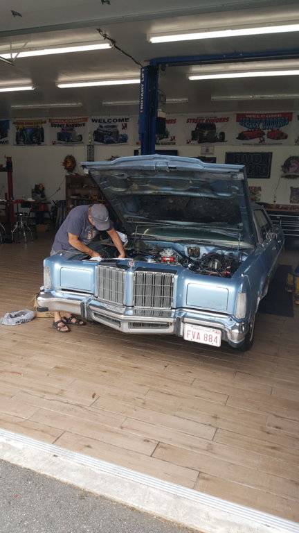

I have 2 Army buddies that I have known and been stationed with since 1984. We still hang out together and the wives have known us all these years and understand we are brothers for life. We still get together every Saturday morning and make a trash run to the county dump and go have breakfast together afterwards. We have always had each other's SIX on the battlefield and in retirement. I couldn't of done my engine build without their help. Neither will take any kind of payment except letting me pay for Saturday breakfast and occasionally letting me buy them a case of beer.
Eric's garage.....
