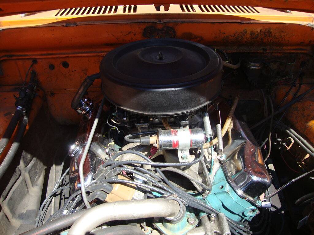

what carb or efi ? you might have to get creative with your air cleaner . i did a 69 383 dart with the eddy rpm intake . there was very short room for an air cleaner , but i was using an afb , there taller than holleys and most efi's . this is it in my 64 d100 . it sits tall .
