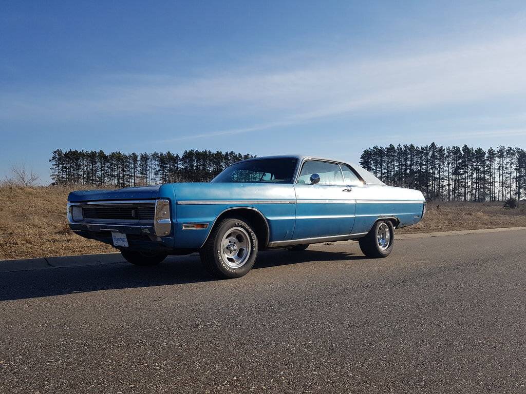

This is my Polara with a bit of an extra arch to the springs that I had redone.
Stock rear shackles...
I was told that since they are re-arched that they would sag again in a few years but they haven’t in the past 5+years of running them
I'm seriously considering adding a 1” lowering block to bring it back closer to the stock stance...
