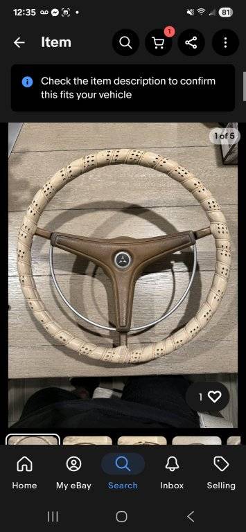

Im looking for a oem style steering wheel like in picture but black is there a name for this kind of padded and wrapped steering wheel and can I buy kit to do it myself thanks in advance
Im looking for a oem style steering wheel like in picture but black is there a name for this kind of padded and wrapped steering wheel and can I buy kit to do it myself thanks in advance View attachment 735265
You need to purchase the leather wrap separate from whatever wheel you get. Those old leather wrappers have become rare, but black was a common enough color, so you might find one. The lace was some plastic stuff, meant to stretch a bit under mild tension applied as you wrap it around the leather.

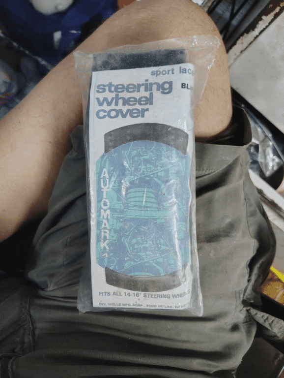

Here's a pic of one I plan to put on my '83 Dodge's wheel:
I redid my '68 Newport wheel to good result with an old NOS blue wrapper! :D They really make an old, chipped, faded, cracked steering wheel pleasant to use again. I wish you luck in getting one.
those covers were what you'd buy in the 80's at places like Pep Boys to hide the fact that your wheel had cracked...I wouldn't put one on a good wheel cause everybody would think you had a bad one...Google "classic grip steering wheel cover" in images and you'll find a bunch of them

In the '70s, the real leather wraps were usually sold by the "better" import car accessory vendors. The DO take a good bit of effort to do RIGHT and TIGHT. As I found out when I bought one and installed it on our '66 Newport. It was also necessary to stretch it a bit for the wheel's diameter, although I bought the correct one.
When installed, it felt nice, but the string was not conducive to "one-finger turning", so I removed it.
