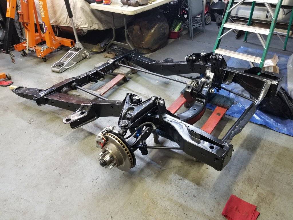

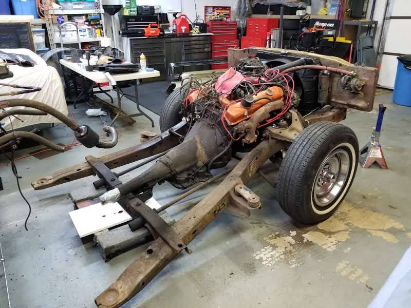

This is stub frame from disassemble of my 1970 parts car.

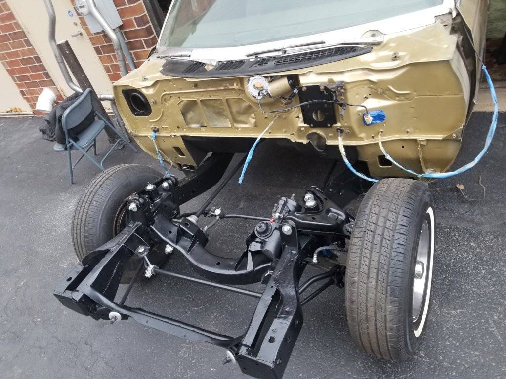

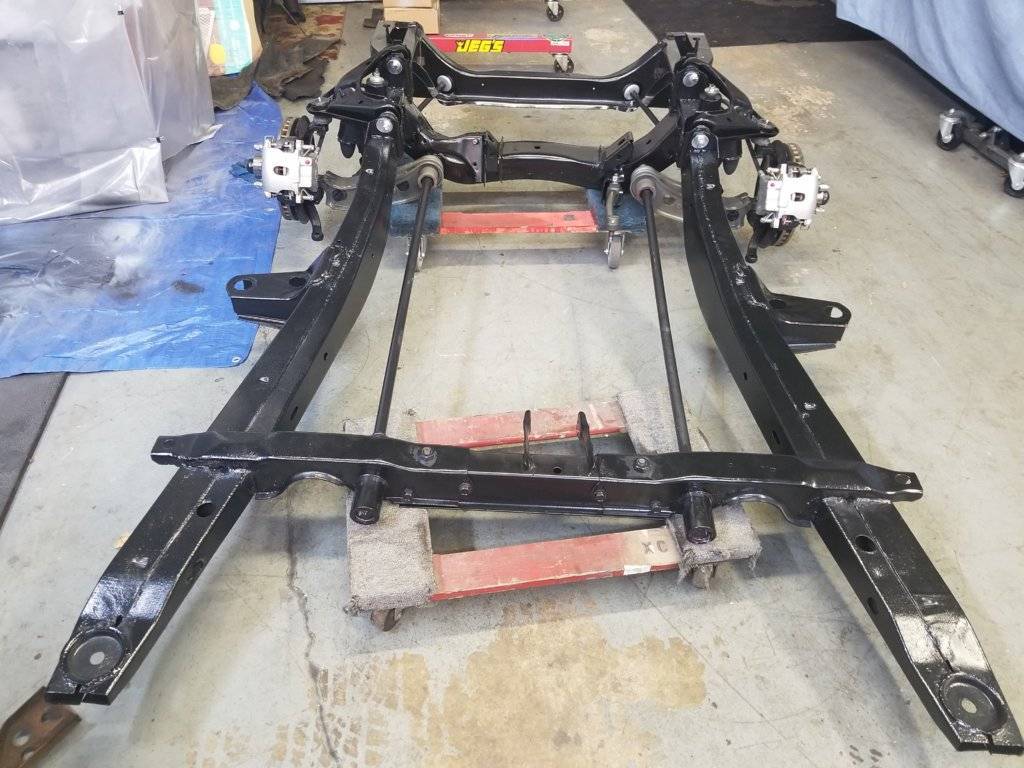

The pics below will give you a better idea of what you're going to be dealing with.
