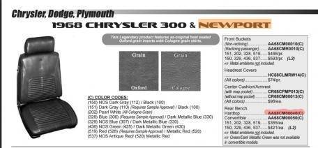

First, super with Your response. Makes sense. But in answer to Legendary and no Newport bucket upholstery, I am fairly sure that that is what I ordered and got.
This is what I ordered (rear "bench" highlighted):
But this is for '68. Is the pattern different for '67?
The way I read that page, that is a rear bench seat for a bucket seat equipped car.
