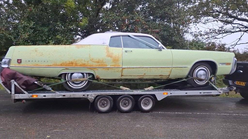

Lebaron coupe is on it's way.....!
Love to hear all updates. This one will be worth the effort. I wonder how many of these two doors are actually still restorable anywhere on the planet.
Can't be many left.

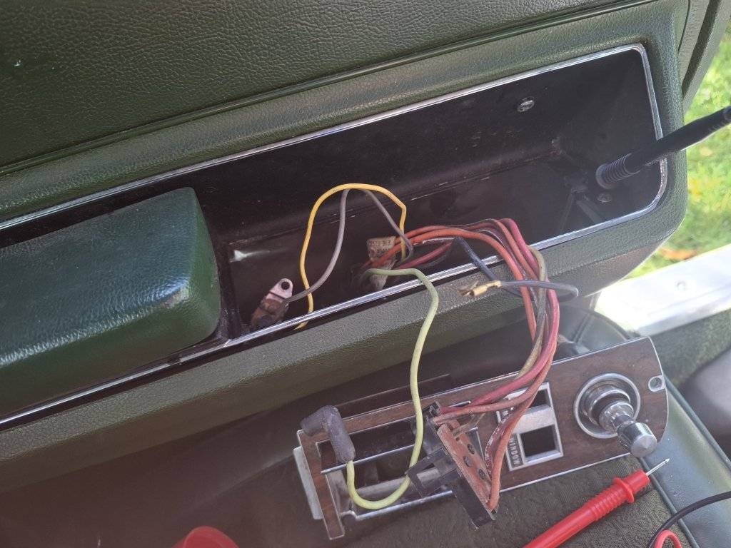

There is quite a list of jobs mounting.. I am about to post the latest in the AC heating thread.......big problems there.
only keeps running if you hold the key in the starting position
Replace the ballast resistor; located in the engine compartment on the firewall, and looks like this:
AC heating... big problems
The HVAC system is likely Automatic Temperature Control; searching ATC on this site will yield a myriad of information.

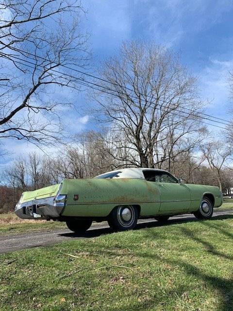

Try some cleaning strength vinegar and a mild scotchbrite pad on the rust oxidized paint. Try it in a lower area first. I would also try a wash with Comet scrubbing powder, it may get the rust colour out of the paint and then you can do a full polish. If you really want to try something, a mild mix of phosphoric acid will get rid of the staining. It will give the car a fresher cleaner look until you take to the finish you desire.
Started on some cleaning. Just one side, to start with. It's definitely looking better.
