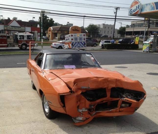

As for all those wrecked cars - what in the world do any of those pictures show about the situation leading up to the accident or the capability of the brakes?
