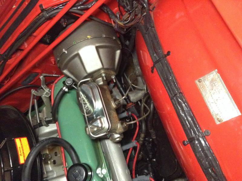

Sorry if this posts twice. The ssbc people are awful to deal with. Nice set up tho. They told me they didn't have a booster for me and a regular one from the drum brakes would work. It doesn't. I saw on another board needed the dual diaphragm booster from 67-68 and that worked with my 68 300. However caution may have clearance issues with column shift cars. I bought the rear from performance on line. Was a real pain in the butt. Easy job but dealing with ssbc not knowing their own stuff made it difficult. Also they sent me 2 bad master cylinders and the wrong rotors. Mc cyl 73-76 monico can get at any auto parts store for 20.00.

what kinda car is this going on ? ralph@ ECI is the head dude over there I think - if it can be figured out those dudes will know how. so manual brakes you have no booster at all now right? I think you need at least a drum single booster to get enough watusi to push discs? I know ECI had me run with the single boost drum booster that was stock on my power drum car, and it pushes just fine, I didn't have to swap out to a dual diaphragm booster.
