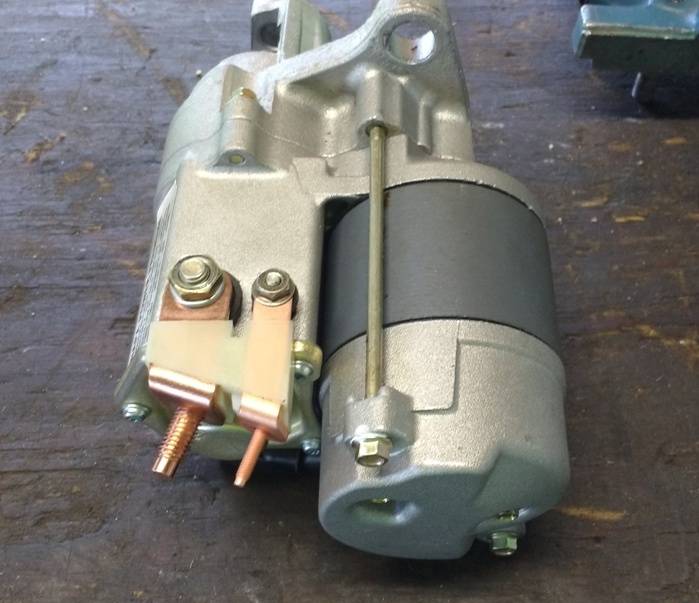

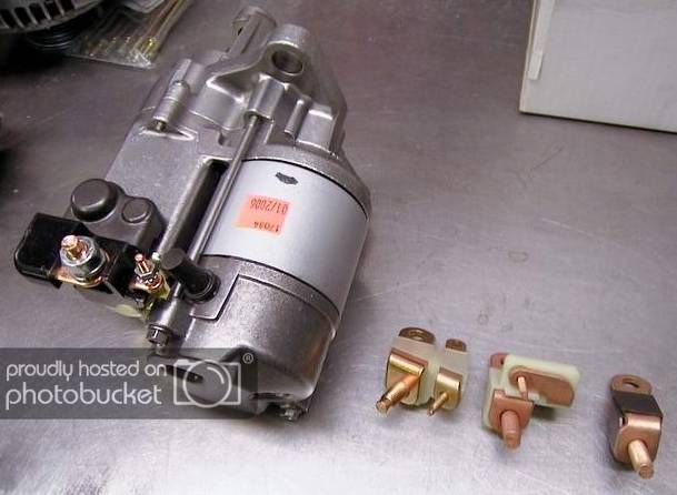

Does anybody know where one can get these Terminal Adapters for the mini starters for the 440 and likely other RB, BB engines? In Canada or U.S.? Thanks.
That is a neat aftermarket item...never knew about those. But I have not had any issue installing the mini starters after removing the OEM adapter and then just installing the wiring on the starter. I know some have clearance issues with the terminal ends and the block.
This is a new one on me, so I did some A body reading, enjoy
mini starter solenoid stud relocation
I did the mini starter swap on my 87 small block, and theres plenty of clearance. I picked up used starter from the local yard for 25 each out of older dakota pick ups. Love the mini starters, the terminal extensions are the icing on the cake.

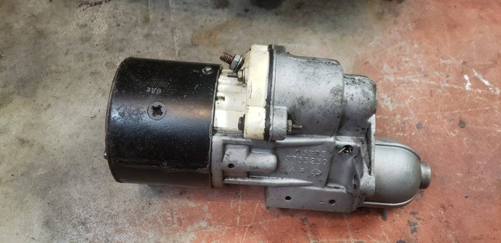

on this starter, the post is loose:
the big post is not flush and is wobbly. How can i correct it? it does not feel like it threads in and I never messed with a starter before so i figured i better ask before i break it :)

That's a old stock weighs a ton starter isn't it? Been a while for me as well, but doesn't it tighten up when you slap a cable on it and tighten it down? Have you ever thought about using a mini? You'll never look or go back to those old monsters again.
it is a old stock weighs a ton starter yes its original - i guess it may tighten down once hooked up - i dunno i am doing what ive never done before so i was scared of breaking it, this forum is the only place i have for knowledge. id swap to a mini-starter but this one works so i can apply that $hundo to something else. so you think its a-ok as is?
Just don't go ape-**** tightening it, just a short handled wrench with a securing twist is all you need. Also known as "good & snug" and you'll be groovy. Good Luck
The big lug has 2 nuts, 1 that holds the stud tight. And 1 that holds the terminal to the stud. Tighten gently the jamb nut against the ceramic housing till the stud doesn't wobble anymore. If it wont lock down the starter will act like it's not getting any juice cause its essentially a contact point for power. Good luck.
