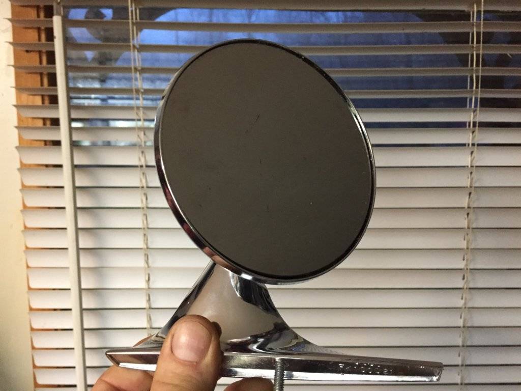

I bought a used passenger side mirror and was told it would fit my 70 Fury, got it home and of course, it is not correct so... can someone please tell me what it does fit?

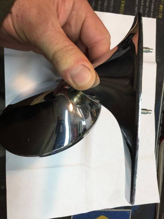

The mirror is definitely for the passenger side, it just doesn't look like the drivers side I have on the car, which I know is correct.

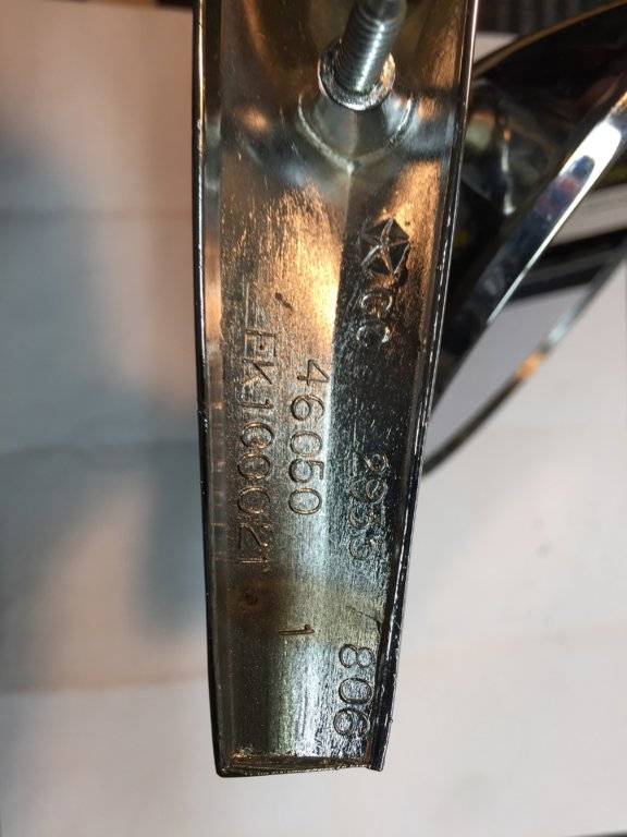

Also have 2935337 NOS Left manual mirror 1969-70 Fury 2935806 cast on
I had the cast number not part number, but it's still a driver's side mirror, as Marty concurs. Swivle the head to the other side and it should look correct.
There are two style mirrors. Remote and manual. That is the "companion" right mirror for a manual left.

While that is true that the mirror isn't remote controlled (cable, joystick etc.). It is a "companion" mirror to the left remote mirror in that it mimics the "hooded" style of the left remote mirror.
That is a non-remote mirror, it appears to be the style that might have been used in 1970.
The number is a casting number and not the part number.
