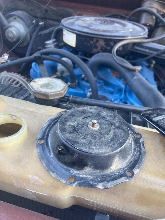

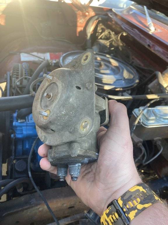

She’s cracked! Anybody know anyone selling replacement diaphragms for mopar speed control units? This one is for a 77 but I think they were the same for a dozen years.
If you’re stuck and need your C/C , servo’s up to 1985 will work as a replacement till you find original parts . I picked up a couple at our local yard for a friend $10 each from a couple 1985 Chryslers .
