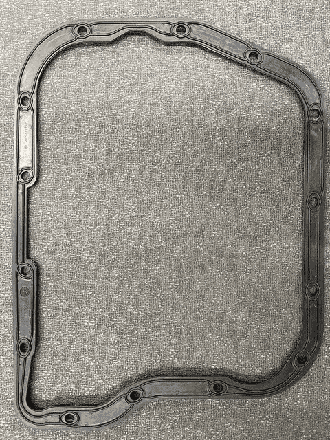

IIRC, you have a big block, so it's a 727 trans and you'll want to use Mopar part #02464324AD as it's the best pan gasket out there. No sealants of any kind are to be used with it. Stress that with your mechanic if you choose to have the work done. It's even reusable.
