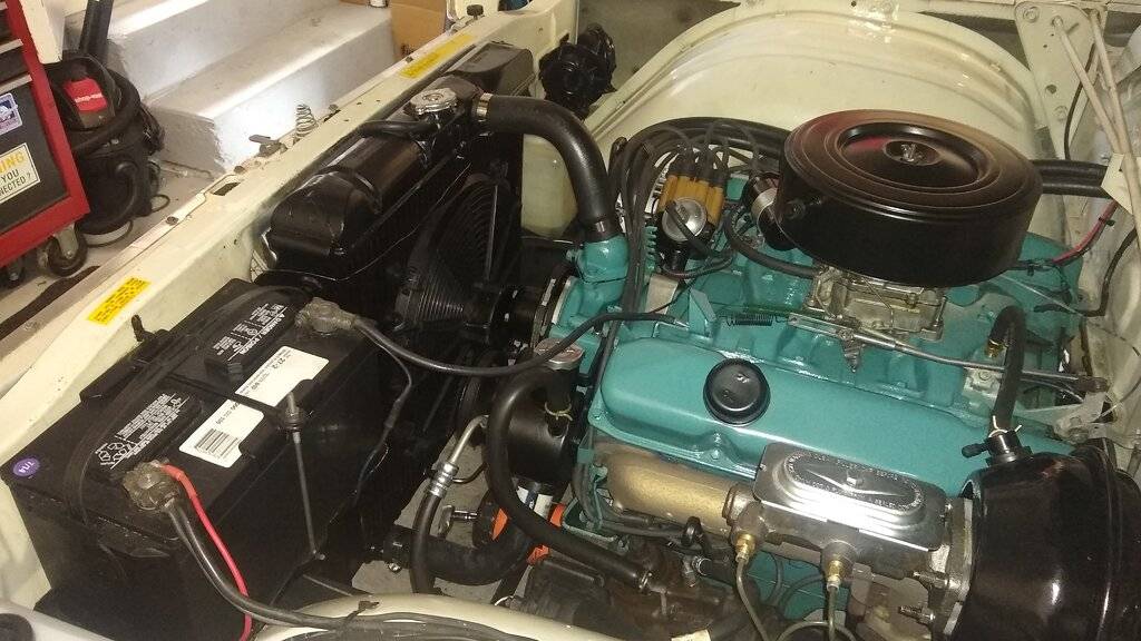

Thanks again fellas. All back together, timing is good. Motor is running at a steady 50psi on a mechanical gauge.

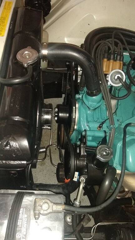

Flushed, cleaned and painted the radiator, removed about a pound of crud from the balancer pulley and painted it. Removed the water pump housing, inspected, cleaned and painted. New high-flow water pump and 180 high flow thermostat installed. New hoses installed with a new stainless steel spring on the bottom... Mine was missing
Next up is the vapor lock issues...which I have the parts for.
