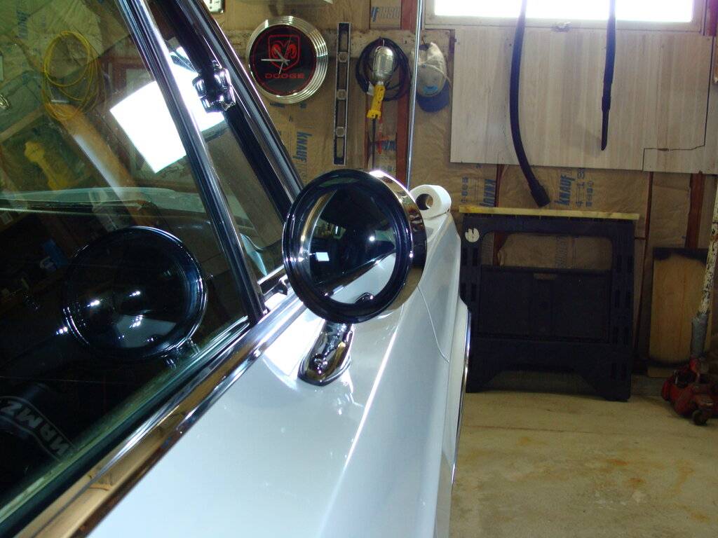

I feel much better with a passenger mirror on a car this big with this many blind spots...even if its just a bit of view. Better than nothing. I found a NOS still in the box from mopar right mirror to match my left remote. Finally got time to install it today. For those that wonder....I mirrored the hole pattern from the drivers door and it sits perfect. Clears the vent window with room to spare and isn't obstructed by the window frame. 67 newport fast top.

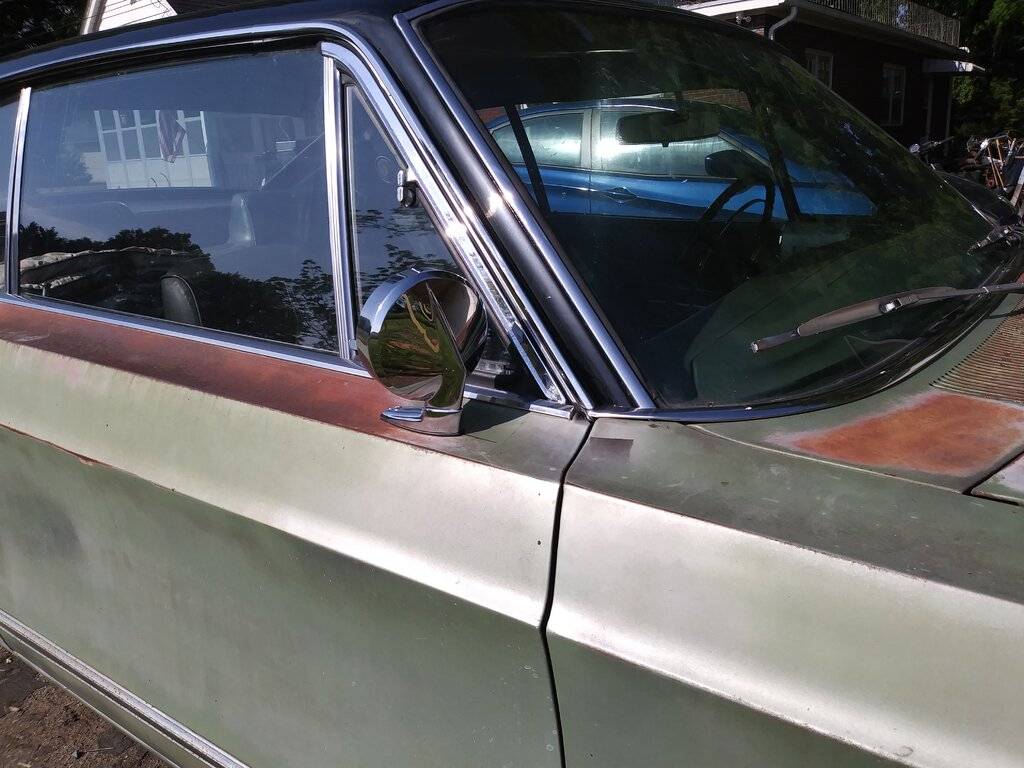

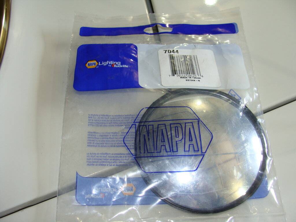

looks nice. Like many, I purchased the mirror and after mounting it, couldn't see anything. A member on this forum posted a comment about the 4" convex peel and stick. I purchased and installed
it. just what the dr ordered
