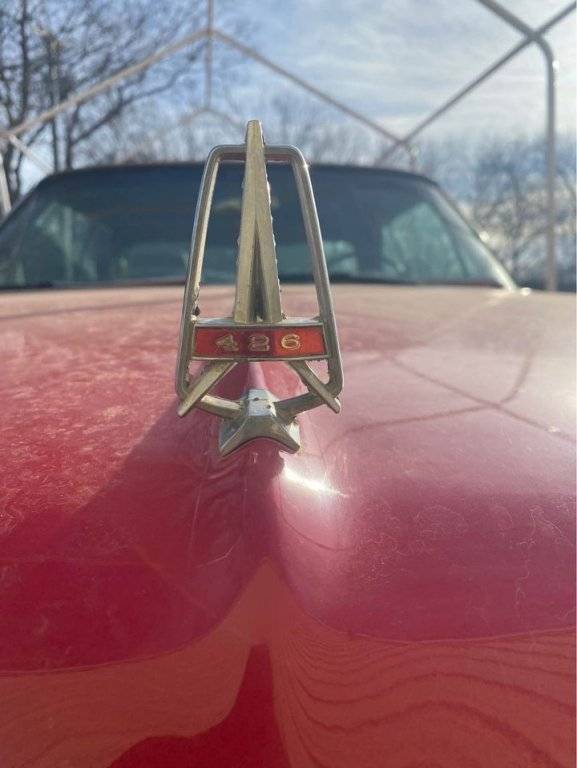

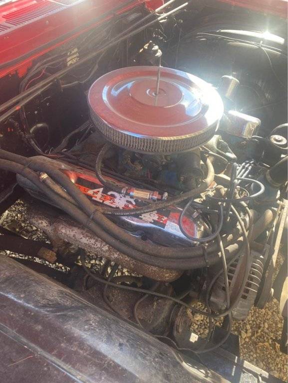

A decal on the valve cover doesn't make it a "Max Wedge".
It is a 426 wedge car (365 HP? ) and that's nothing to sneeze at... but a couple things.. They never made a '65 Max Wedge for one thing, and the max wedge engines never got put in any thing but a B body.
Then there's the intake and exhaust manifolds and on and on... Nothing that says "max wedge" transplant either.

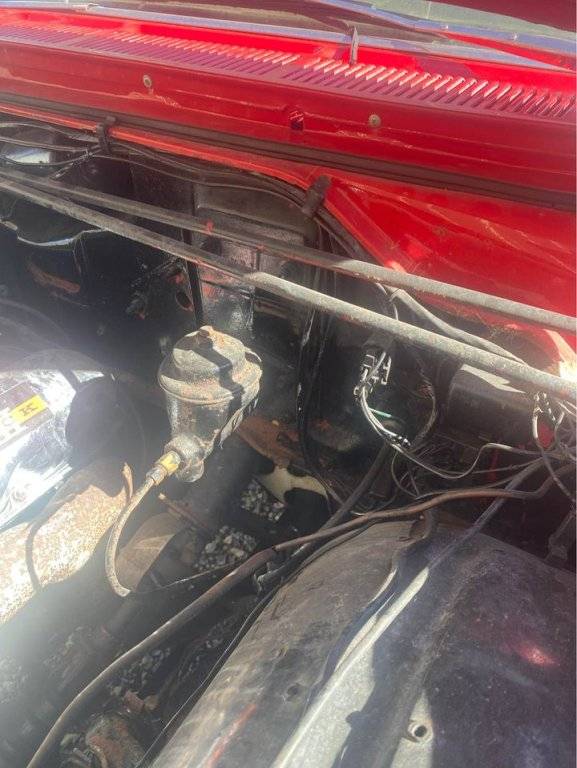

To many things wrong there. The chrome and decals are bright while the rest is almost 60 years old. Closd the hood to hard and punch a hole with the air cleaner shaft. I'm not even close to being a novice but hesitant about this.

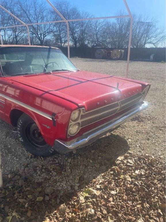

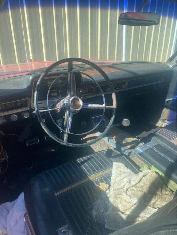

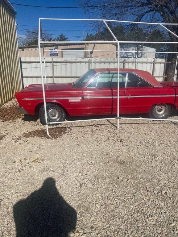

It would cost 3X the purchase price just to bring it back to aa level where it is presentable at a Dairy Queen car show. While the fact that it is a factory 426 4 speed excites the hell out of me, there's no way I could afford it once it got into my garage. Every single piece on the car looks like it's a #4.

I'd rather have a 383 4-speed car that is ready to run, vs a 426 4-speed car that needs a lot of work. (or even an AT car that was really nice)
While this red car isn't a basketcase, I sense it's a car that you could easily drop $3000 in and it would still look mostly the same.
Would need to drop more money in to make it comparable in condition to the black car.
The 6" tall air cleaner stud that @DCMC mentioned and the black tape holding the trim on are enough to make me question the rest of this car.
