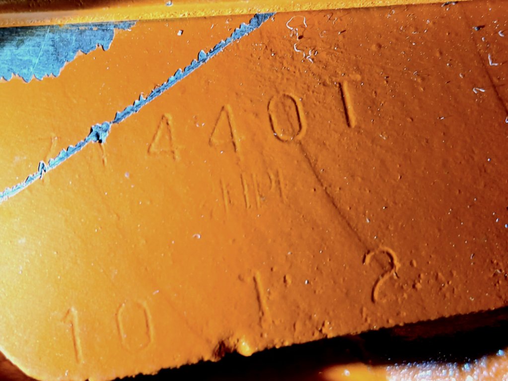

I'm building this engine for a friend and I've never seen a block stamped like this. It's a 1977 630 block cast 9-18-76 but there's no VIN or serial stamped anywhere on the engine, pan rail or starter pad. The top ID pad has what looks like a faint HP or maybe HP1 stamped under the 7T440T. Usually the HP is stamped in the same font on the 1st line, like my other 77 HP 440, but here it's different. I'm thinking this is a dealer short block assembly for an engine replacement.
Knowing the guy who had it, it could be out of a police car but he has so many 440s he can't remember. Usually, cops would just decommission and sell a car if they blew the engine, I've never seen one with a dealer block, unless this one was blown with so few miles the car was good enough to save if they had a tight budget.
Any other ideas where this thing came from?
I'm thinking a truck 440. My 78 truck didn't have the VIN stamped in either. The heads castings are a little different too around the spark plugs.
The pictured engine is a 1977 440 truck engine built at the Trenton Engine Plant, in Trenton Michigan, on October 1, 1976 during the second shift. The first "T" in 7T440T denotes Trenton, and the second "T" denotes truck. The stamp that looks like "HP" on the engine pad was likely added by someone else. The lack of VIN stamping on the engine pad or elsewhere, was customary for truck engines then. It was not mandated by law for trucks at that time.

Imo looks like a typical truck/rv 440 that someone down the line wacked an HP stamp in. Definitely not original..

No 440HPs were used in trucks. Trucks & motorhomes typically didnt get a VIN stamped in the block like passenger cars.
