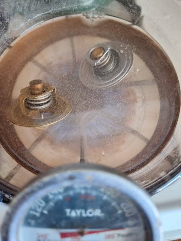

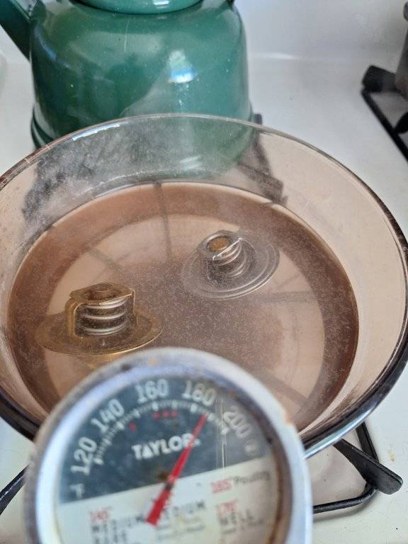

I decided to replace my thermostat, bought a new one (on the right in the pictures) but did not have the gasket sealer. So, to fill my time I decided to see how well the old thermostat operated compared to the new by placing them both in a pot of 188 degree (see pic) water. The old thermostat opened quickly, the new did not begin to move until 220 degrees (est. see pic), and really opened at 225 (est. see pic) degrees.
As often, online information lacks specifics when you compare different sources and what I found for the normal operating temp for a 1967 440 is an operating range of 175 degrees to 235 degrees. My questions are these: 1. Is the old thermostat opening quickly because it's old and worn out? 2. Is the new thermostat, opening at about 220 degrees, functioning correctly (NOTE: the parts guy at O'Reilly's said it's a 180-degree thermostat.)? 3. At what temp should a proper thermostat open for this 440?

The new thermostat is made in Israel by a company named Murry according to the box. It's rated at 195 degrees. The old one is rated at 160 degrees. I just found the ratings stamped on both thermostats. So now I need to figure out the ideal operating temp for a 440. As I mentioned, the internet ranges from 175 to 235 degrees. That seems too big of a spread to make a decision.
Forget "The Internet", what the cars came with was a 180*F thermostat. When emissions came to be a larger issue, then they went to 195*F thermostats, OEM. No difference for factory a/c cars or not.
To me, if someone perceives their engine will make more power with a 160*F thermostat, so be it, BUT that is a more specialized application where "coolness" is desired. Whereas a normal engine needs something warmer for decreased cyl wall wear and a heater that gets hotter quicker in the COLD times of the year.
In a Rochester Carburetor book by S-A Designs, it was noted that greatest power is really made with a warmer engine, which might extend up to the 235*F range. So "cold mixture" warmer cyl block?
The differences in how the two thermostats acted can be somewhat explained by their temp ratings, to me. Lower one "snapping" open as the other one was lazier.
To me, the "best" option can be something between 180*F and 195*F, unless you have a '55 Buick which still can tend to overheat with a factory 160*F thermostat. Cyl bore wear was not important on those Nailheads as they had higher-nickel content blocks and cyl heads.
In order to get a baseline for YOUR engine, start with the 180*F thermostat and go from there.

guess you answered your own question....yes a 160 themostat will open a lot sooner than a 195...now the next question is "why did it have a 160 ?" many times folks will put in a lower temp thermostat in an attempt to "cure" an overheating issue caused by something else...so you may have an issue once its back together with a higher temp thermostat
