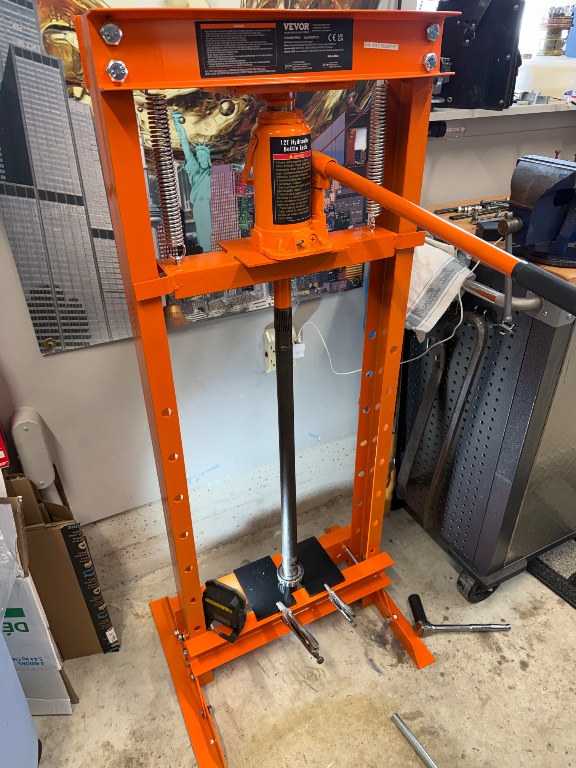

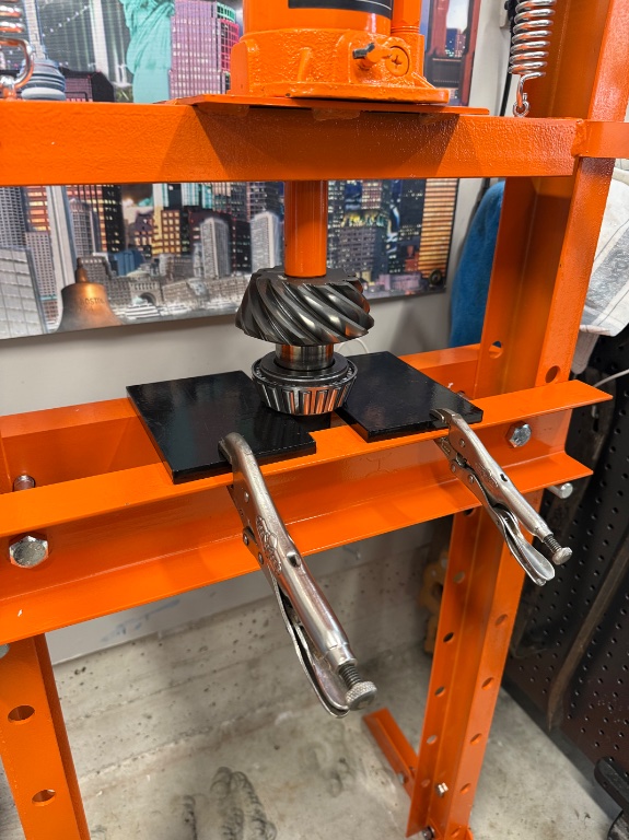

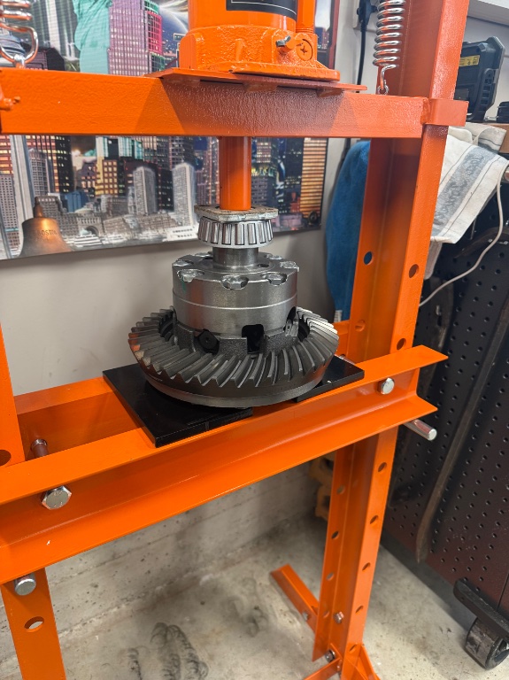

just this week I completed what you’re contemplating. I purchased a 12 ton Vevor press off Amazon Canada as I’m in Ontario. I’m rebuilding the centre section 8 3/4 3:31 differential in my 1960 300/F. I also replaced the axle bearings. I’m in rural Ontario. This unit was perfect and I paid $166 including all taxes and delivery. In total I pressed on 5 bearings, one for each axle, one on each side of the new Suregrip unit and one rear pinion shaft bearing. The front pinion bearing doesn’t require pressing. Anyway, as you know, purchasing off of eBay if you’re in Canada is painful with respect to taxes, duties, delivery and of course exchange rates. Unless it cannot be located anywhere else I avoid it like the plague.

I had to cut the bearings off using a dremel tool and a 1 1/2” fine reinforced fibre cutting wheel. First cut the cage off, the rollers fall out and you’re left with the hub. Slice it carefully with the dremel then give a couple of blows with a hammer and screwdriver and it’ll split allowing it to slide off easily. It is almost impossible to get them off any other way, the interference fit is far too tight to pull them off. I do have pullers and attempted to, but after seeing a few you tubers using the dremel that was clearly the best way to go. As a side note, I’ve never seen eBay offer free shipping to Canada from the US, usually it’s only free to 48 states from my experience.

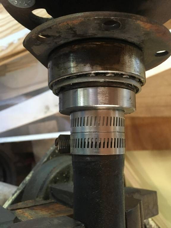

Ok. I saw your first pic of the shaft on the press and it looked like it was set up to push the bearing off.

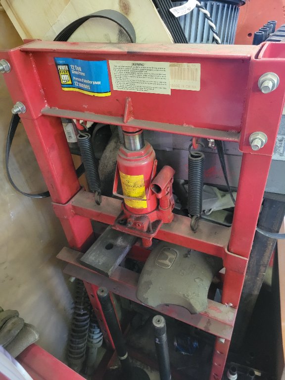

Here's my 12T PA press I got probably 10 yrs ago. Kinda springy, but works in a pinch. Back in the day when necessary, we'd just pound them on with suitable pipe and BFH

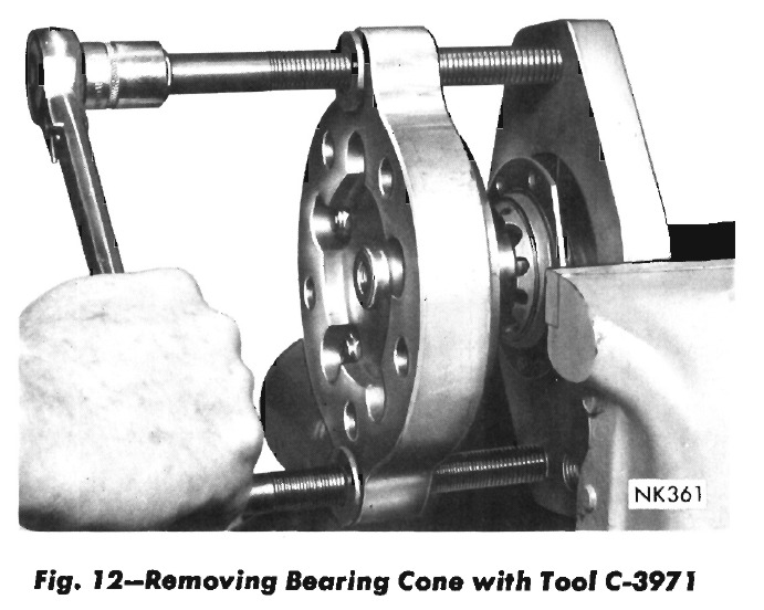

What I don't get, according to the manual, is this step about removing the bearing cone. This is after the retainer has been hacked out, and after the race, cage and rollers have been hacked out:
Is this thing pulling the cone to the left? Or pushing it to the right? If pushing, is the tool piece on the left bolted to the shaft flange?
Without the tool, and without taking a grinder to the cone, can the cone be pushed off with a press? But an old thread on FABO says you can or will bend the axle ... ?

While in theory, you can press the inner cone off, the issue is having the proper tool to do it. There's not much to grab and hold, this is why the FSM shows that tool. The tool shown in the FSM is pushing it off.
The easy way to do it is just cut it off with a cut-off wheel. You have to cut the sleeve and the outer shell of the bearing anyway, so it's another 5 minutes to cut that off too. I know that's not the way the FSM does it, but that's the way everyone does it. But, do it whatever way you want.
The Mopar tool is around... Figure on killing $100 though and I don't think it will work for anything else. Put a couple hose clamps around the bearing surface to protect it from the grinder.

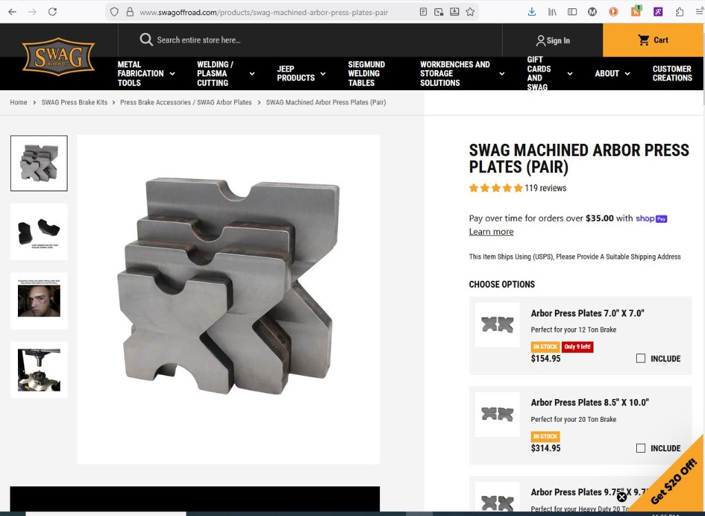

I'd like to get a pair of those heavy thick "X" plates that I see in some video's but it looks like PA doesn't have them and I don't know if anyone sells those on-line.
These are the probably the best press plates available. Of course, being the best, they are pricey, and I'm sure shipping to Canada would be very expensive too. I bought a set of these some years ago, and they're really nice. I think it was before the Covid inflation run and they were about $50 less. The cheap, cast iron press plates can be dangerous.
SWAG Machined Arbor Press Plates (Pair)
Jeff
I did a search for press plates on harbor freight but found nothing (well I found 1 thing but it wasn't these plates). Do they not sell them as an accessory?
I can buy brake rotors (made in god knows where) for $14 on rock but these stupid plates (that could be forged by a cave man) cost $100 each?
On Amazon.ca I see a pair (Augrex brand) for $200 cad including shipping. 1 x 7 x 7. 21 lbs for the pair (about the same weight as a single front wheel drum).
