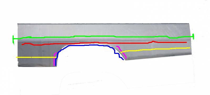

ok, this question comes up quite a bit. i bought a pair of these as seconds (damaged). they were cut in half . since they were cheap, for an experiment i thought i would see what i could make out of them. i'm using a pair of original skirts to size up the wheel opening and approximate the contours. here is what i have found.
green: the body line should taper from front to rear. it does not
red: the lower side of the body line is indented. it should be flush with the top ridge of the body line and curve to the lower edge of the panel
yellow: the curve should be more from this point down
pink: the wheel opening shape is wrong here. should be shorter in the front and longer in the rear.
blue: this is the tough part as there should be an inward angle around the inside of the wheel opening approximately 3/4" and then returning to the flat inner lip.
all of this without fitting it to the car for any final changes and adjustments. the opening for the reflector will need to be addressed also.

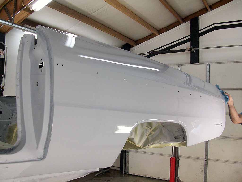

here is an example (not mine)of what it should look like. if i get the chance i will get pictures of where i'm at on this project.

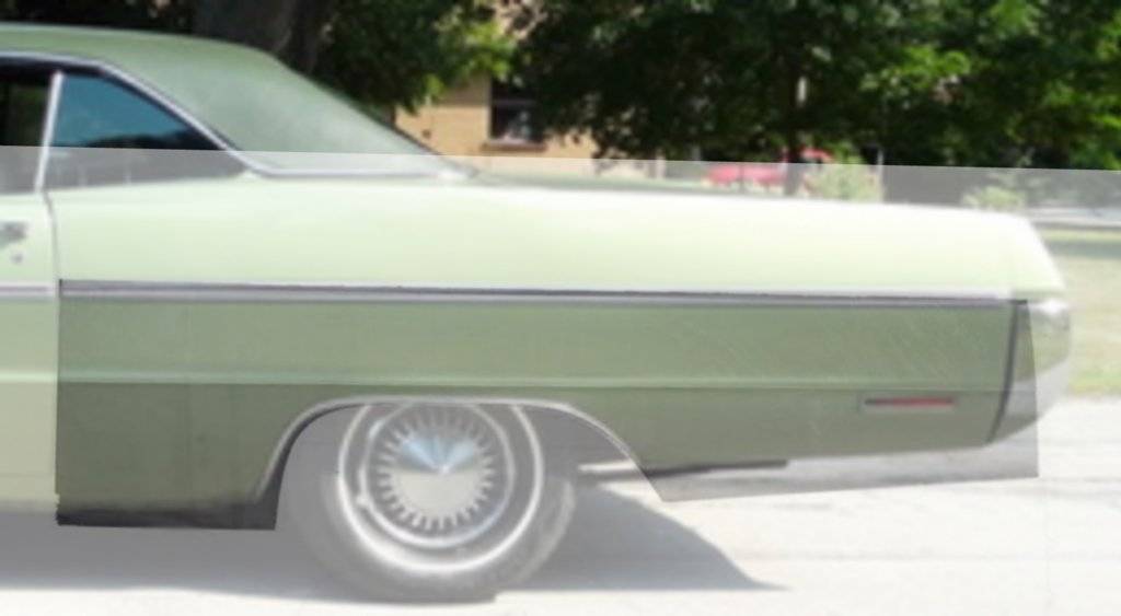

Here is the FLAT (in three planes) replacement panel overlaid on an a 72 Fury.
Can you see how it's impossible to "wrap" the panel in all three planes and have everything line up? It can't be done.
Try conforming a playing card to the surface of football without wrinkling it. You can't.
You can't curve a playing card in two planes at once.
that is a perfect example of what i was trying to illustrate above. it shows everything that i was trying to explain. it can be done but it takes a lot of slicing and dicing in the wheel opening to get the curvature right. removing the indent under the body line is proving difficult and i'm not sure what if anything can be done to fix the taper of the body line.
