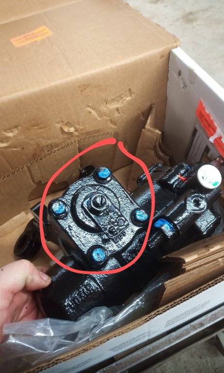

I'd be careful with a cheap rebuilt steering gear. There is a real good chance it is a Cardone brand rebuild which are pretty much junk anymore. They basically clean and paint cores and call it rebuilt. Firm Feel and Steer & Gear are companies that are exclusively steering and suspension related so their quality control would be of a higher caliber. BAP is just selling parts so they go for the cheapest available, just to sell parts. I would contact both FF & S and G and inquire about the rebuild process and if they rebuild them in house or outsource.

Firm Feel would be a bargain at twice the price. Why? You'll never have to think about that steering box again, and you won't be removing a leaking Cardone that you paid for, only to have to sent IT to Firm Feel to be fixed correctly, like you should have done in the first place.
But you WILL have to paint it, because FF doesn't drench it in the gooey black paint that Cardone does when they falsely claim that their goods are "rebuilt".

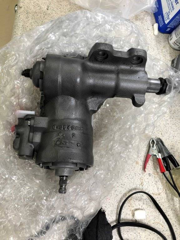

[As for the battery charger leads, I was charging up the new steering box before installation. @david hill told me to. :poke:]

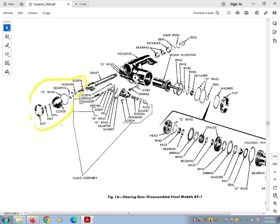

Great comments here gentlemen ... I think I know what I need to do regarding my rebuild. I have another thought however, I'll throw out there. The rebuild is a costly deal for my budget, but likely the best way to go for the long term money-wise ( and prob what I'll do ).
I can't help but keep wondering if it is feasible to try and stop the leak on my gear box instead. My leak is coming from around the adjusting screw outer "lock nut" and I was wondering should I try to just replace the seals ( O rings ) in that area? Can that be done while still "in the car", or would it need to come out regardless? So you understand, and can answer me better, here's a video showing where my leak is coming from. www.flickr.com/photos/25722625@N06/53546276450/in/album-72177720314990030/
IF replacing the seals is possible while in the car ...How in the heck do you get that lock nut off, what tool does that? Anyway I was just curious if a repair is doable .... but I think if I have to take it out of the car either to replace the seals or have it rebuilt ... then I'll just go for the rebuild. I will say that other than the leak, my cars steering has be fine, it has just a little play yes... but nothing odd otherwise.
Thoughts?
Again look at the video to see my leak in action, and I attached a blow-up schematic of the box and highlighted the area of my leak and the seals I would need ( where to find those seals would be another mission )

You can get a valve body o-ring kit. If you take the valve body off, it must be put back in the exact position, so scribe a line along the edge.
I have rebuilt one myself. You can get a rebuild kit from Rockauto. Get the kit with the bearings. You will need a spanner hook wrench, a clamshell pitman puller, and a gram fish scale. Only do it yourself if you have a service manual from Chrysler. Keep the iron rings on the piston, the Teflon rings in the kit may be too tight.

If you look closely at the top of the sector shaft adjustment bolt it has an allen key provision to hold it so you can loosen the lock nut. It is probably full of accumulated gunk so hard to see. Easy to replace the seal then. In the old days of yore a wheel alignment always included a sector adjustment as the first step. You can't get a good alignment if the steering gear is flopping about. With the wheels pointing straight ahead turn the adjusting bolt in slowly until you can just feel the gears touching and the back it out about a quarter turn. turn the wheel lock to lock to make sure there is no binding. If there is, back out just a touch more and check again. With everything being rack and pinion these days this step is skipped because most techs have not been taught how to do this. If tie rod ends are good this will eliminate a good portion of your steering looseness. With todays radial tires you need way more caster than the original +- .7 degrees that the original upper bushings allow for. You can get aftermarket parts from several companies that allow for +- 1 1/2 degrees. Last time I looked Rock Auto had them for a very reasonable price. You need about double the original caster just to get radials to stop feeling squirmy on the road and if you can get a bit more the better. This will also firm up your steering feel just little bit as well. The alignment shop will probably argue about this but stick to your guns and you will be very happy with the results.

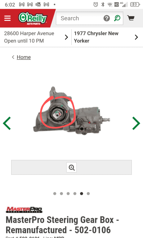

Based largely on the strength of Steve's recommendation above, (which interestingly enough is also on the O'Reilly website) I had this box shipped to a store in my area.
Upon unpacking it in the store I noticed it is different in the sector shaft area. See the photos I attached. I'm wondering if this perhaps a slabside-era box which is functionally the same as a fuselage and formal steering box? It might account for the slight difference in mounting hole as well. On a hunch I also looked up Dodge truck steering boxes and to my relief the mounting is completely different. So has anyone seen the style before? It has been a while since I've owned a lovely slab side. And do you know if it will fit in a formal era Chrysler? Photos are from the O'Reilly website and "real life".
Just thought I would follow up on this...
This box sold by O'Reilly's obviously intended for some other vehicle. That said, it does fit with about 3/16 of an inch removed from one of the mounting bolt bosses. Essentially ovaling one of the mount holes. No issues with the steering column attachment, power steering hose connections or the pitman arm. I think it's a good replacement considering the price. ($169, $40 core) Steering in the car feels good now, I wouldn't say better than new, but at least as good as new.

I am unable to answer Carmine's question about mounting the gear to a slab side but I can say that this unit is made by BBB Industries. They also make remanufactured Federal power steering pumps for our C bodies and they also manufacture new mini high torque starters for our cars. I have bought several of each of these in the past and have had no issues but I don't have but a few thousand miles on most of them. I do trust them to go the distance since none of my mini starters has gone bad like the junk you find on Ebay. I have had a couple power steering pumps on a couple of my cars too and no issues over several years now (including no leaks).
Also a friend of mine has had one of these steering gears on his 1971 Chrysler 300 and drives that car everywhere and has accumulated 10's of thousands miles on that car and it is still going strong (he is also hard on his cars since he drives them roughly in my opinion - goes at high highway speeds and around corners and does burn outs all the time too). His AVS II carburetor also has instant carburetor response on any light or hard accelerations. So given how hard he drives and plenty of miles on his cars, I am confident that their products will go the distance and the AVSII carbs have also stood up well.
However, on my show/garage queens I stick with all original parts but for cars I can enjoy more often I see no drawback to the BBB or Carter's latest offerings. I bought some of the BBB Industry steering pumps from NAPA but I believe they also offer the BBB Industries mini starters and steering gears as well. I am not sure how to tell which of their items are for certain the BBB units based on looking at their on line offerings but maybe there is information available to the staff at NAPA as to who the real manufacturer is. That NAPA offers the BBB Industry parts as well suggests they are premium products in their eyes at least and O'reillys also may carry their other offerings as well besides their power steering gears and probably at lower prices than NAPA.
