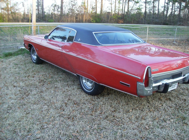

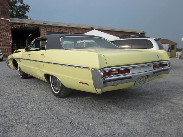

The side marker lights / reflectors are in different locations on the 69 vs the 70 & up fury's if that matters and is only aesthetics. The 69, 70 & 71 are the closest match as you can see the 72 & 73 are much different unless your using just the very lower portion of the quarter but even then in my eyes not worth the effort.
1969 Fury
1970 Fury
1971 Fury
1972 Fury
1973 Fury
There you go, it is alway funny how quick people are to correct missinformation.
I didn't realize the 72/73 were so different than the 69-71. I always look at marker lights as a secondary problem, fix the damage then worry about looks, often the markers can be relocated.
